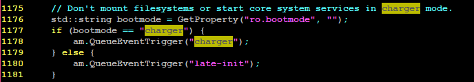

We are developing on i.MX8MQ and Android 8.1 BSP. We have battery and need charger manager.
We have implemented the battery/charger drivers and the healthd daemon is working well. Android shows correct battery capacity and charging/discharging information. The question is if we power on the unit by plugging in the USB-C adapter it should boot into “charger” mode that shows a big battery icon on screen and plays charging animation. The method is setting “androidboot.mode=charger” in uboot but when I did this I didn’t see that the “charger” service is running. I can manually start the charger service by the following commands on the console:
$ su
# charger
It then starts the battery animation on the screen that is corresponding to the real battery level, and with the following logs (see attachments):
[   19.315741] charger:
[   19.318054] charger: *************** LAST KMSG ***************
[   19.323904] charger:
[   19.326273] charger: last_kmsg not found. Cold reset?
[   19.331353] charger:
[   19.333634] charger: ************* END LAST KMSG *************
[   19.339481] charger:
[   19.341763] charger: --------------- STARTING CHARGER MODE ---------------
[   19.383070] charger: Could not open animation description at /res/values/charger/animation.txt
[   19.391753] charger: Could not parse animation description. Using default animation.
So the key is to automatically start the “charger” service when “androidboot.mode=charger” is set. I tried to modify device/fsl/evk_8mq/init.rc and system/core/rootdir/init.rc, but it didn’t work. In system/core/init/init.cpp it triggers the “charger” event when boot mode is charger but it looks not working:
Can you help have a look on this?
Attached are a log that including the manual starting of the charger service, and a picture when the charger service is running.
It looks that we just need a simple setting in init.rc that starts the charger service if boot mode is charger. I did the following changes in init.rc, but it doesn’t work:

Thanks and we've resolved this issue. There was a SELINUX policy issue with the charger service.
