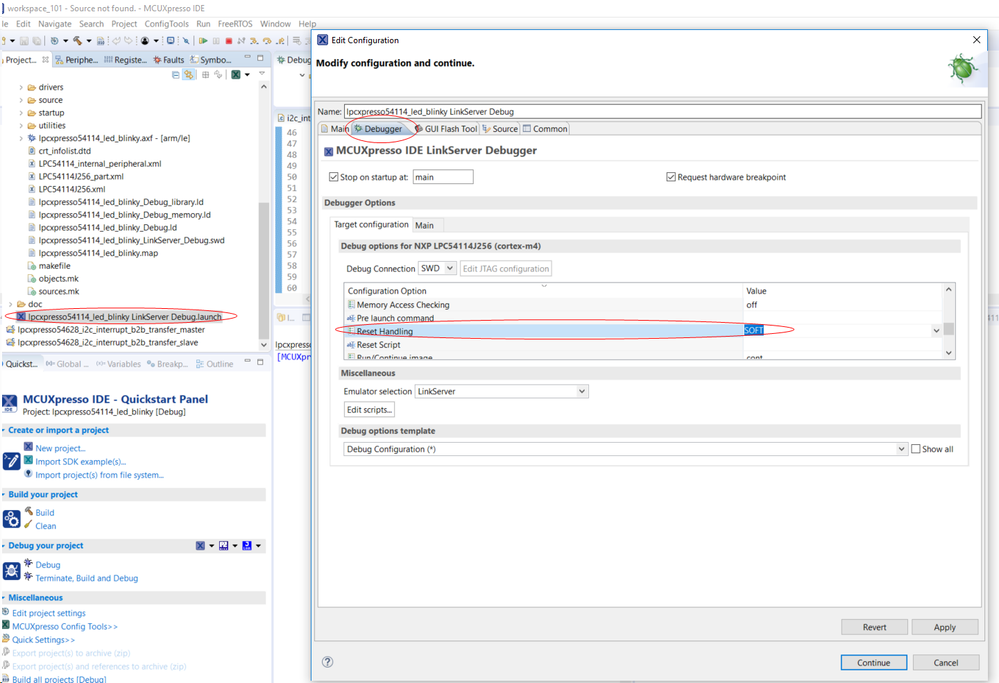

Hello Otavio Borges,
1)In default,  the MCUXpresso IDE can't debug application with start address from 0x3000( only can start from 0x0000).
2) About the bootloader,  does application file have been flashed into chip before jump.  There is some secondary bootloader demo , you can have a look:
LPC82X|NXP
Hope it helps,
TIC
4,639 Views
otavioborges
1) Is there a way I can debug the application. For example using gdb's add-symbol-file;
2) I've tried the approach on the mentioned demo. But with no luck. But raised some questions. Why does the demo uses SYSMEMREMAP instead of VTOR to change the IRQ interruption vector? Would both approaches work on LPC845?
4,639 Views
Hello Otavio,
I should add something after my last reply,
" 1)In default,  the MCUXpresso IDE can't debug application with start address from 0x3000( only can start from 0x0000)."
when using  CMSIS-DAP or linker server debug probe,
we can re-configure the "Reset  Handing" to SOFT as below, then can debug your application .
TIC
