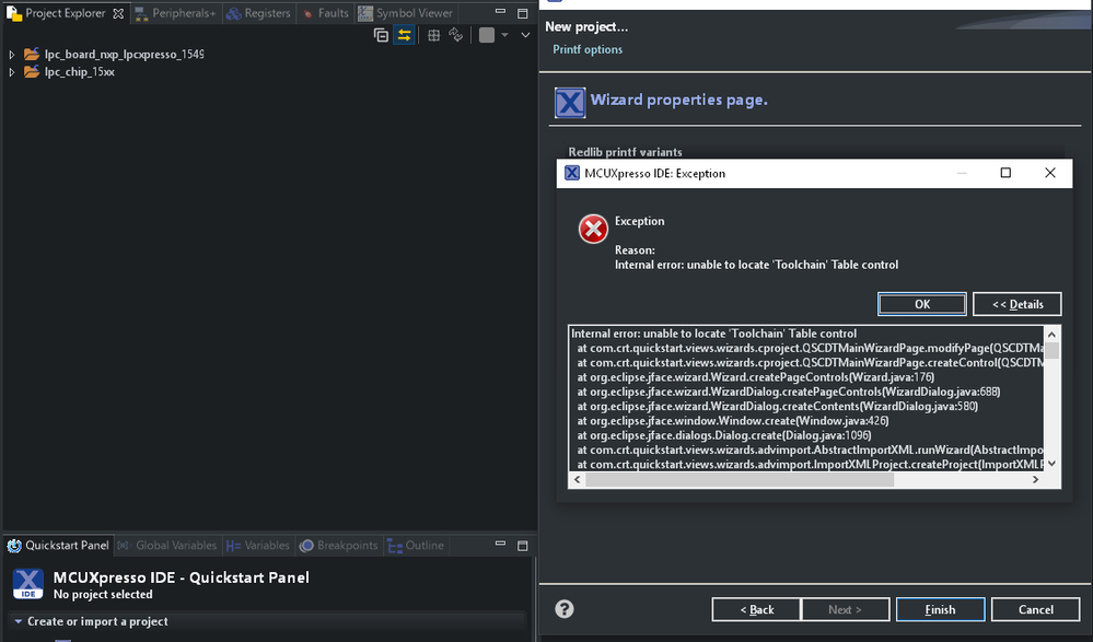

I wish to create new project using MCUExpresso with LPC1549 development board so I followed the procedure in
IDE
and it generated this error, see attached.
I'm using, The MCUExpresso is MCUXpresso IDE v10.2.0 [Build 759] [2018-05-15] (will upgrade to 10.3 later).
However I clicked OK and carry on, the code compiles without error, I have not yet tested the board (let hope it work okay). I wish to note, the Next tab did not turn on correctly during the procedure, please try it out.

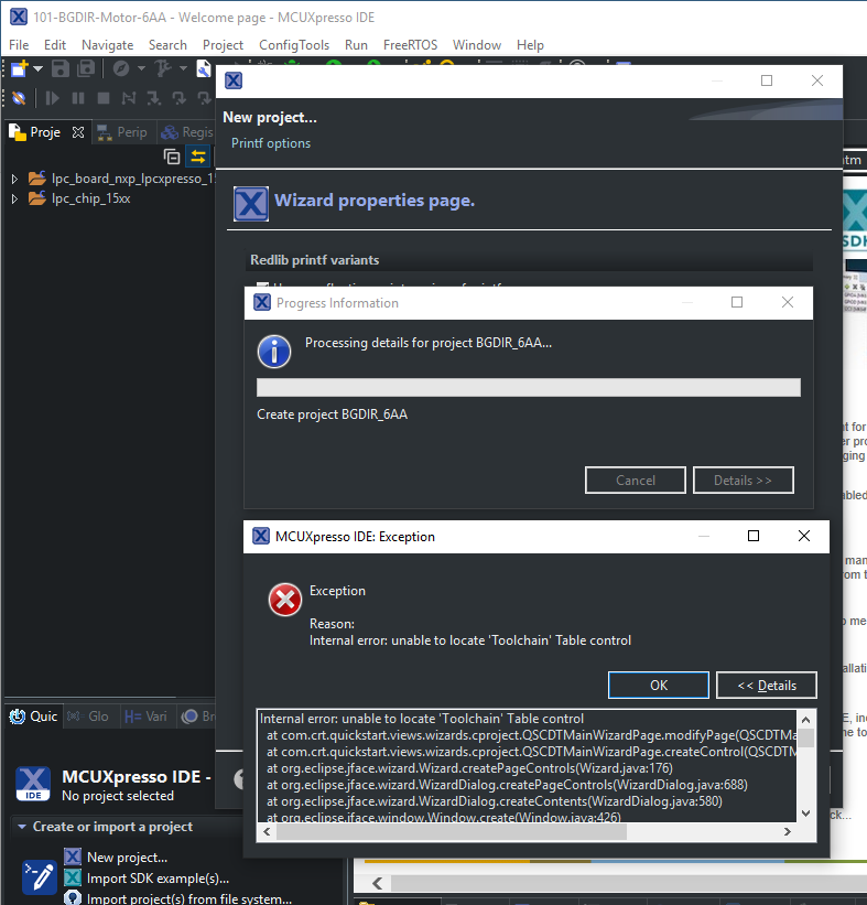

lmatte
Here it is the same sequence done as in video from ZhangJennie, for an LPC1549 board, same bad result as with LPC1769

lmatte
I confirm it's an issue with MCUXpresso IDE version 10.3.1 (latest, as of today), not showing on version 10.2.0 (the one tested by ZhangJennie above); I installed 10.2.0 on two different systems (including the one where I removed a 10.3.1) and the error doesn't appear anymore.
Note that I didn't test versions in between, so I don't know when/where it starts happening.
7,704 Views
lmatte
Sorry to detail more in a sparse way, but I have some news for this case.
The problem can arise again, even with version 10.2.0, if you happen to install DevStyle/Mylyn extensions -- as I did in the examples above, to have the Darkest Dark theme.
Without these additions there's no error, so something has to be incompatible...

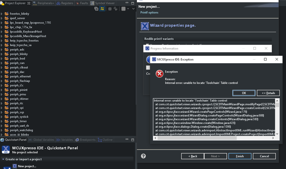

lmatte
Same error here, as shown below.
I just created a new clean workspace, chosen "New Project", selected the LPCXpresso1769 board, all the projects from the supplied SDK
  "C:\nxp\MCUXpressoIDE_10.3.1_2233\ide\Examples\LPCOpen\lpcopen_2_10_lpcxpresso_nxp_lpcxpresso_1769.zip"
Gone forward adding nothing else, and here's the result.
I've attached the ".log" file, as asked to OP

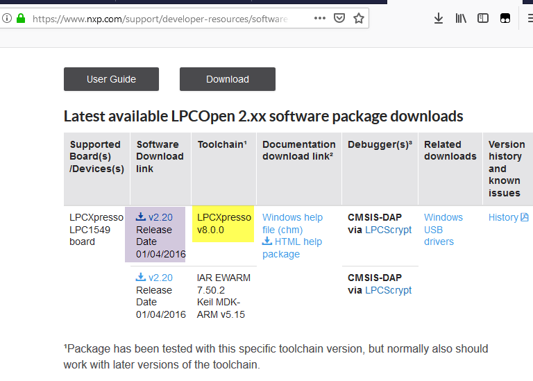

ZhangJennie
Hi Richard,
I tested LPCOpen under MCUXpresso IDE 10.2.0. There is no error. See attached video.
I suggest you create test it again with creating a NEW workspace.
You may also try reinstall MCUXpresso IDE in case this is a system issue.
Besides, please also check if your lpcopen package is for LPCxpresso. lpcopen can't work normal if you selected wrong tool chain.
