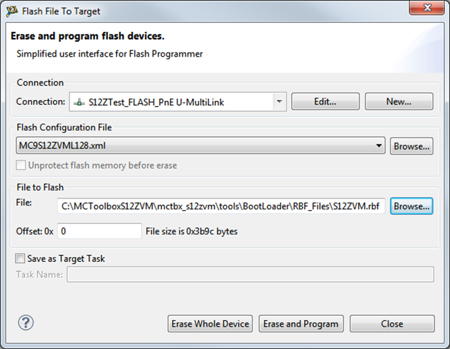

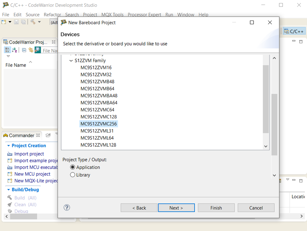

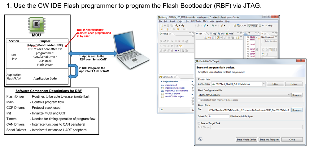

To have the capability to download the code automatically from Simulink to the NXP target you need to flash a bootloader on the actual microcontroller. This bootloader can be flashed with the CW for MCU using a JTAG probe. You need to do this only once since the bootloader is resident in the flash. Later on – this bootloader will allow you to load code directly from USB or CAN interfaces into the microcontroller memory.
Below is the overview of the process:
#1: Install NXP CodeWarrior 10.7 or newer from the official page here
#2: Create a bareboard stationary project for the MCU you are using:
#3: Open the Flash File menu and select the RBF file associated for that MCU
#4: Make sure the JTAG connection is configured correctly and click on ERASE and Program button
Once the RBF is flashed into the MCU memory then you can download the code automatically from Simulink or from RappID bootloader UI.
Hope this helps!

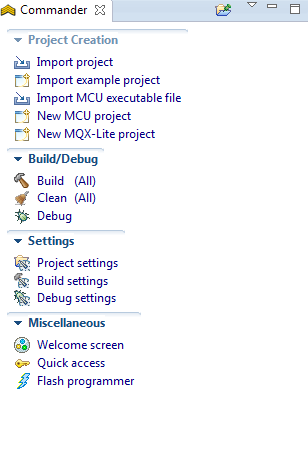

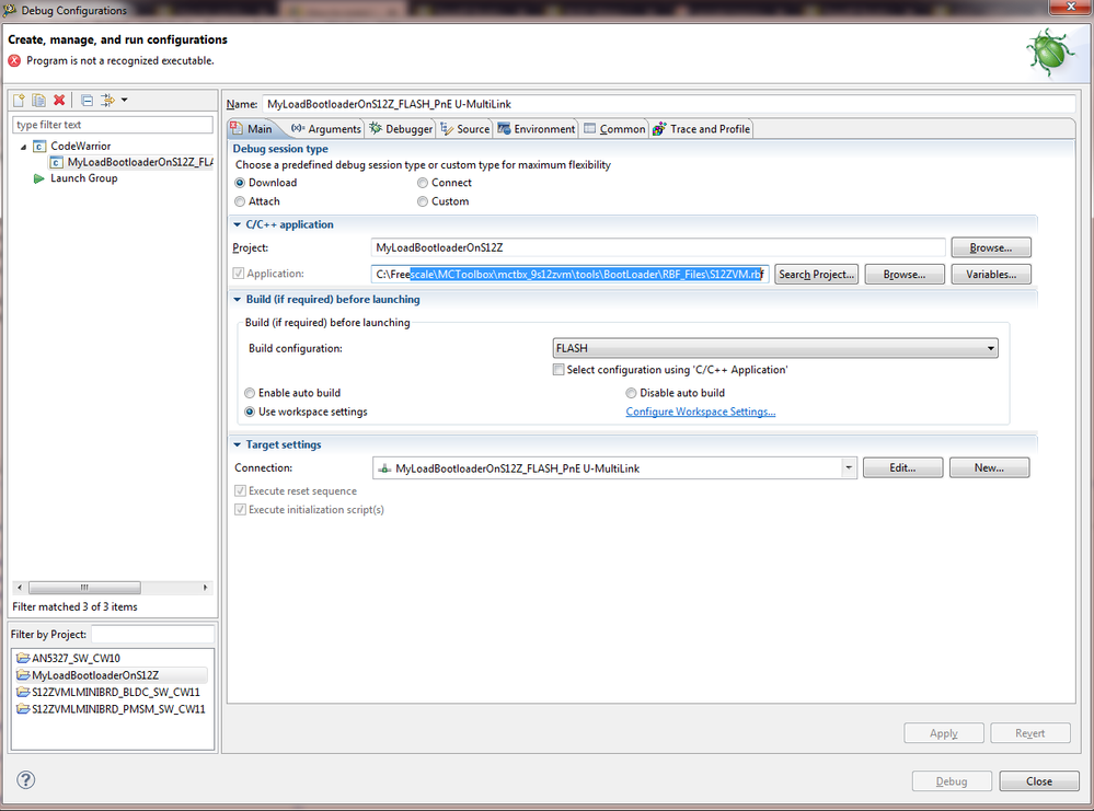

in Code Warrior (Version: 11.0.1) where can I find the "#3: Open the Flash File menu and select the RBF file associated for that MCU"?
I tried under "Debug Configuration", but somehow I can not flash the "S12ZVM.rbf"

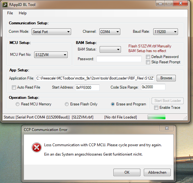

When I try to flash the bootloader with "RAppID Boot Loader Utility"
What do I need to flash the bootloader?
Many thanks

I can find now " Flash File menu" and It works! :smileyhappy:
Tony

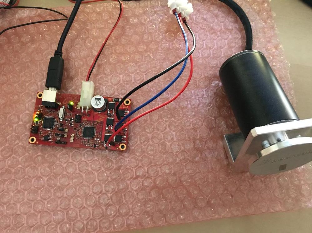

Hi Daniel,

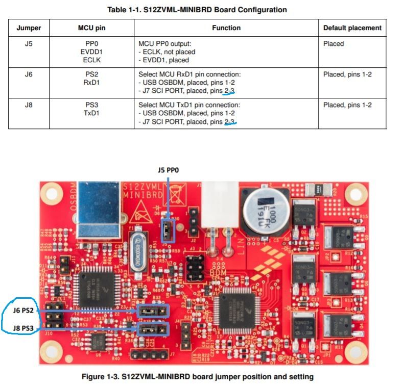

    I have a question for the s12ZVM Mini Board for my motor. Why the board can be detected and connected with OSBDM cable but the SCI cable (usb2serial port) failed?
   The usb virtual serial port has been tested and the dirver work great. I can use the serial port software to test the
serial port work in great condition.
  Let me know if you know how to configure the usb2serial cable and makes the computer detect the ml128 mini board.
Many thanks.

Hello thomsonzhou‌,
Can you try setting J6 and J8 to 2-3 position, as described in the photo above and then test SCI?
Hope this helps,
Razvan.

I installed the universial CP2102 usb2sci Driver with j6 2-3, j8 2-3 and j5 placed.
The baud rate is set to 9600.
My serial adapter is based on CH340, thus I also installed usb2serial port driver named CH340.
And fully tested with the serial port software. And it works no any problem.
Thus I really do not konw, how to use serial cable to connect with the ML128 MINI board.
Need your help.
Many thanks!

Hi Razvan,
    I did exactly according to your above configuration. But the usb2SCI port communication still does not work.
    I just installed the SCI driver for CP2012. But the desktop still could not detect the ML128 MINI BOARD.
