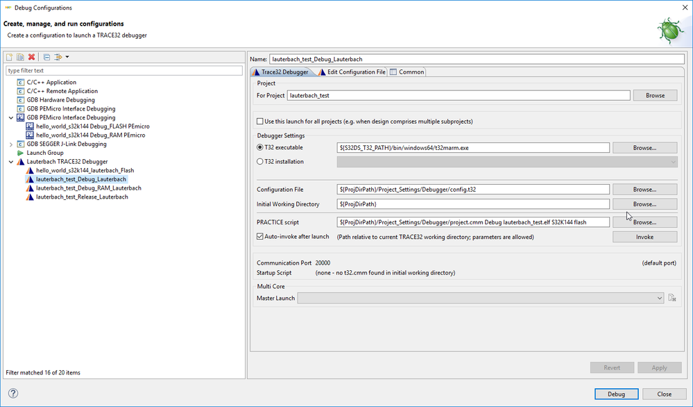

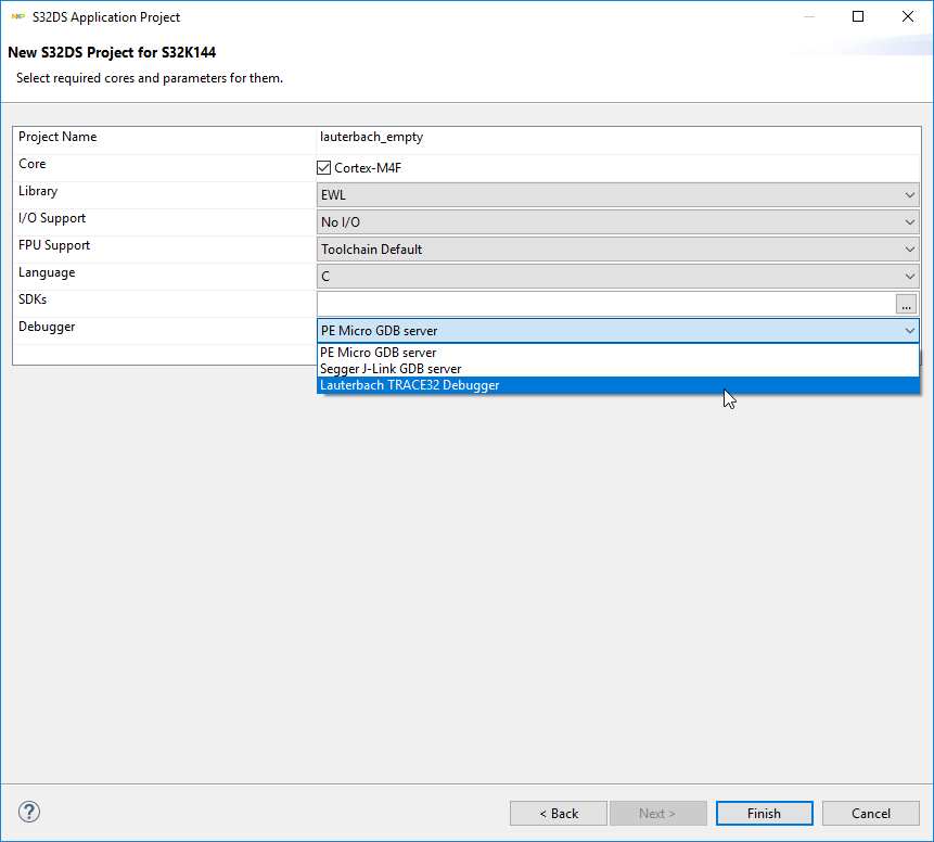

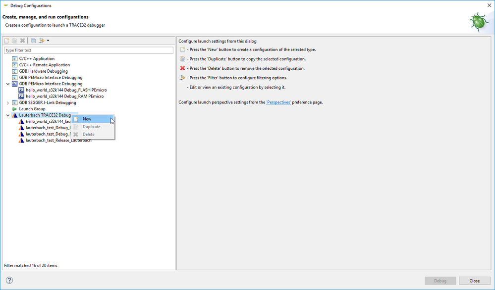

I don't have Autosar MCAL installed - but you can add lauterbach debug session in debug configuration. The easiest way is create new empty project, select lauterbach debug:
Copy Debugger folder from empty Project_Settings into your existing project and create new Lauterbach debug session.

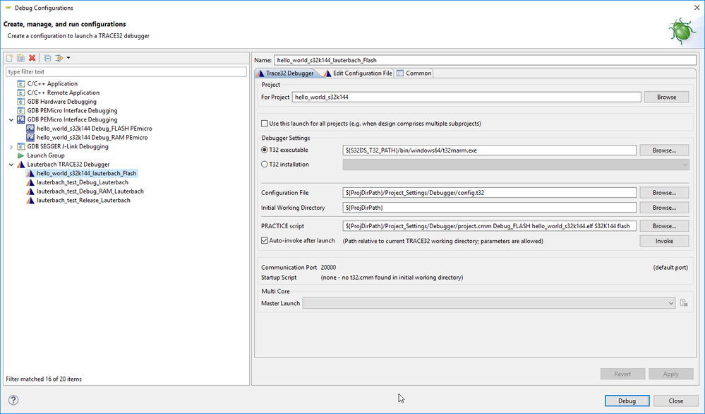

You can edit the .launch text file in Project_Settings\Debugger or copy line by line project settings in the GUI from empty project to your Autosar project:
The empty one:
Your existing project (in my case Hello_world):
When done - just click on debug and wait for T32:
