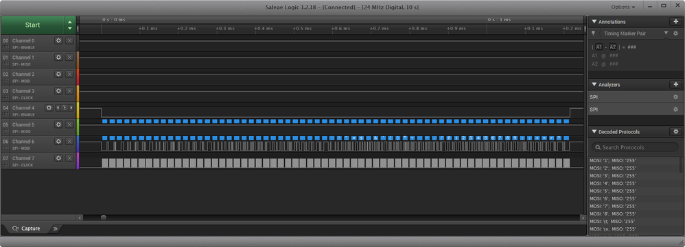

Greetings,
I just found another bug on NXP's SDK 2.3.0 (maybe on older versions as well, haven't tested it), this time on the driver for SPI over DMA (master) when using SPI instance 1 on a Kinetis microcontroller model MK22FN512VLH12.
My environment:
* Win 10 Pro 1709
* KDS 3.2
* SDK 2.3.0 for FRDM-K22F
* Dev Board FRDM-K22F
Using the demo application under SDK folder\boards\frdmk22f\driver_examples\dspi\edma_b2b_transfer\master\
First test: Original application (SPI0):
* Transfer Size: 64 Bytes (original)
* Transfer Size: 32 Bytes
* Transfer Size: 4 Bytes

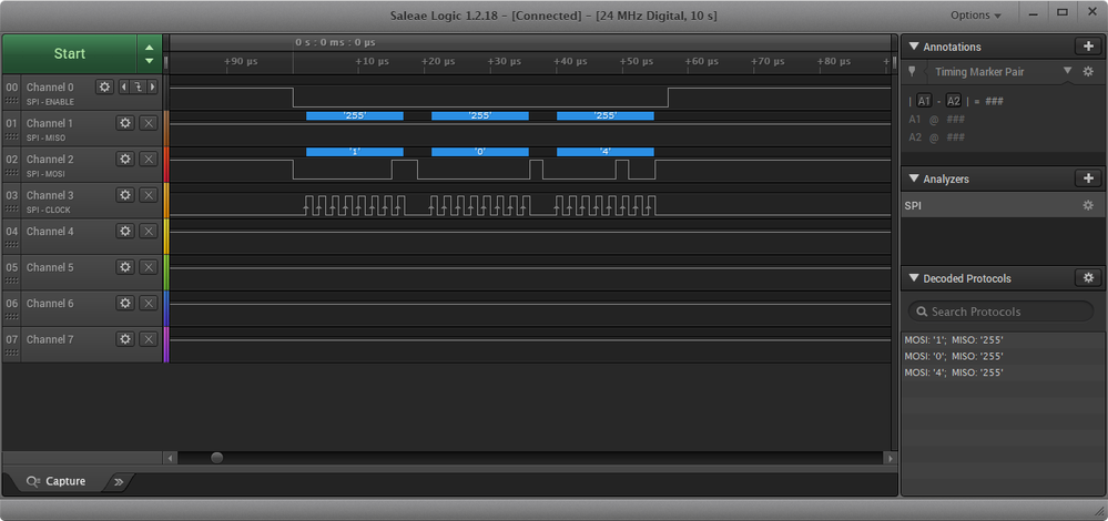

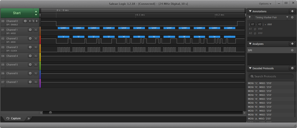

Second Test: Application changed to SPI1:
As can be seen, not only the amount of data to transfer is not transferred, the first 2 Bytes are wrong (instead of send '1' and '2', it sends '1' then '0').
Has any one had this problem and solved it? Anything that I'm doing wrong?

Hi Bruno,
The SPI1 instance has a shared DMA request for RX/TX and the DSPI EDMA driver expects only the RX DMA channel to be triggered by the RX request and the RX channel and will then link to the TX channel.
So in your code, you should remove the EXAMPLE_DSPI_MASTER_DMA_TX_REQUEST_SOURCE macro definition, this way the following code will be disabled by the preprocessor:
#if (defined EXAMPLE_DSPI_MASTER_DMA_TX_REQUEST_SOURCE)
    DMAMUX_SetSource(EXAMPLE_DSPI_MASTER_DMA_MUX_BASEADDR, masterTxChannel,
                     (uint8_t)EXAMPLE_DSPI_MASTER_DMA_TX_REQUEST_SOURCE);
    DMAMUX_EnableChannel(EXAMPLE_DSPI_MASTER_DMA_MUX_BASEADDR, masterTxChannel);
#endif‍‍‍‍‍
Let me know if this solves your issue.
Gerardo
2,955 Views
brunoalbrecht
Sorry for the late reply and thank you for your message. Indeed the proposed change solves the problem.
From what I understood, the same request source was being assigned to two different DMAMUX channels, which was confusing the peripheral, so to say.
This topic can be closed.
