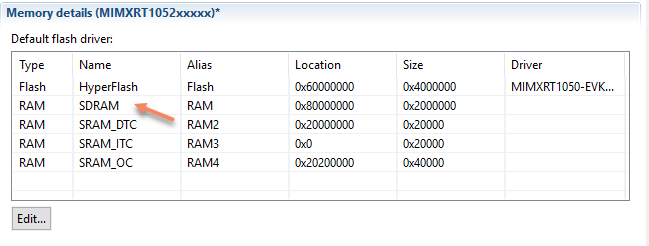

I started out with an MCUXpresso SDK 2.3 sample project for using FreeRTOS and I customized it to create three tasks and an event queue for dispatching requests from two of the tasks into the third. (freertos_queue example) The initial SDK example project ran out of SRAM, so I converted the project to run out of hyperflash on the MIMXRT1050-EVK.
This step was performed using notes from Overview of using the MIMXRT1050-EVK with MCUXpresso IDE to convert a RAM project to XIP from flash (doc v104, page 17).
At this point, the project builds and runs well, however the heap used by FreeRTOS along with all other data memory resources come from SRAM_DTC. This area maxes out at 128KB and the project that I am preparing for will use several hundred KB of heap space. For this reason I am attempting to use the MIMXRT1050-EVK SDRAM (32 MB) device.

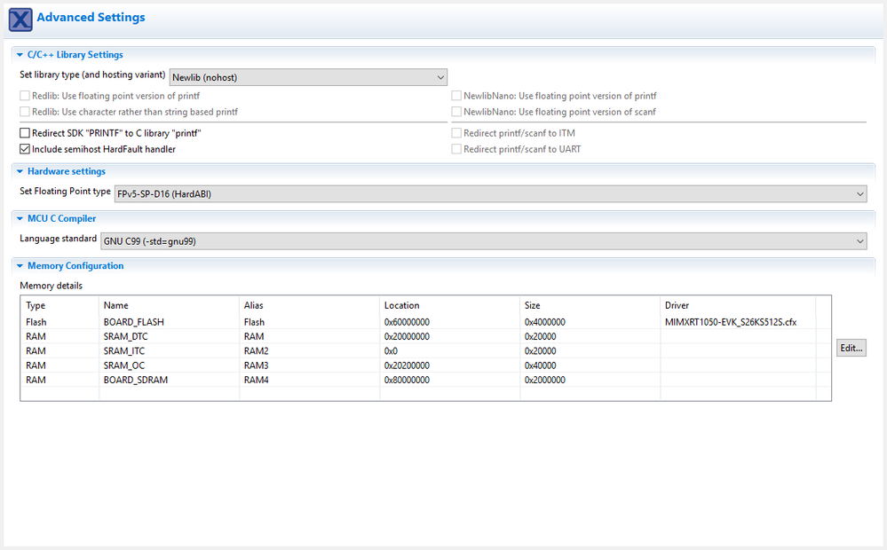

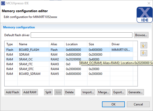

I changed the project config for memory details to include an SDRAM section and positioned it immediately below the hyperflash section.
I then edited FreeRTOSConfig.h and increased my heap allocation:
/* Memory allocation related definitions. */
#define configSUPPORT_STATIC_ALLOCATION 0
#define configSUPPORT_DYNAMIC_ALLOCATION 1
#define configTOTAL_HEAP_SIZE ((size_t)(500 * 1024))
#define configAPPLICATION_ALLOCATED_HEAP 0

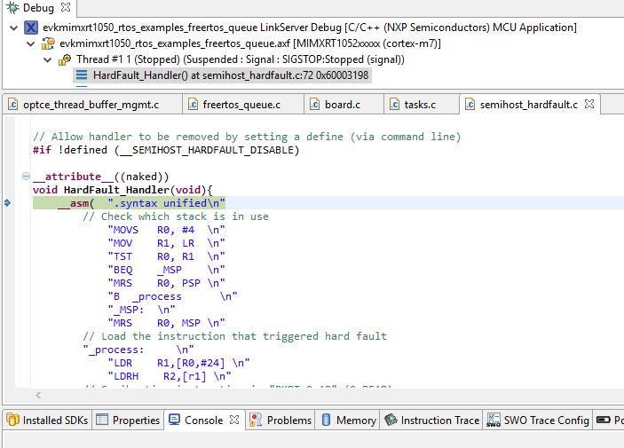

The build completed error/warning free, but I get a hard fault thrown at runtime.
By decreasing the heap size to 30 * 1024, I no longer get the hard fault, but rather my second of 3 tasks fails to create (pvPortMalloc call returns NULL). My queue and task that uses the queue create without problems.

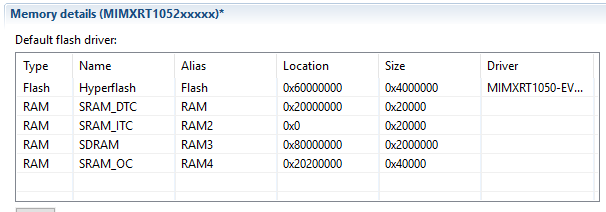

I've not been able to replicate this behaviour. When I reorder memory, the heap/stack settings remain mapped to the SDRAM (as long as I have referenced it by name rather than alias name).
I can only think that the specific order you are making changes is exposing a "hole" in when the IDE will force the regeneration of the linker script.
Try doing a clean, then rebuild - this will force a linker script regeneration. Then check what is shown in the linker output for the memory region usage (towards the bottom of the build console), as well as looking at in the linker map file and the generated linker script in the "Debug" (or "Release") folder of your project.
MCUXpresso IDE Support
7,297 Views
edw8
I always clean first before build. I don't believe that to be a problem. Similar to your experience, I switched my memory configuration where the SDRAM bank was not the first RAM bank, and I could not reproduce the problem. SP originated in the SDRAM region as did heap allocations with some basic test code. I tried several memory bank sequences and they all worked correctly.

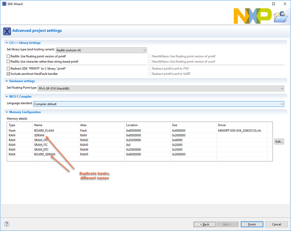

So I went back to the drawing board. There are two ways I created starter bases for my project. The first is by creating a new project using the SDK facilities. That project was based on freertos (not baremetal) and included the default set of drivers and utilities with exception of the assert utility (addon). No middleware. Going thru the MCUXpresso IDE prompted screens for creating the project, I realized that it comes up with an invalid memory configuration. An extra SDRAM bank is added to the memory config list.
At this point, I create the project with the default config. After project is created, I edit the config and take out the SDRAM bank, leaving the BOARD_SDRAM bank in place. When I click on the SDRAM entry, the dialog shows an invalid configuration error until I remove the redundant SDRAM entry.

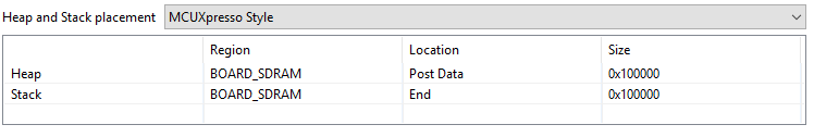

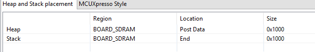

I then edit project settings again and change stack and heap regions to BOARD_SDRAM.
I clean, build, and debug. I set a breakpoint at the entry of the while loop and run. After hitting the breakpoint I check the SP and notice it is correctly placed in BOARD_SDRAM space.
The second method I used to create a project base was to import a demo SDK example. I selected the FreeRTOS queue example. For both this method and the previous method I set the SDK debug console to UART and set the library type to Newlib (nohost).
This method presents a memory config block with a single SDRAM bank, however this project is set to run out of RAM.
I create the project and change project settings to have the project run out of FLASH, while setting Heap and Stack regions to BOARD_SDRAM. I add xip project driver source and add the XIP_EXTERNAL_FLASH preprocessor include.
I add a breakpoint at the log_init() call, clean, build and debug. When I hit the breakpoint I check the stack pointer and sure enough it is in SDRAM space.
I ran thru these two setups a few times with mixed results. With stack and heap regions set to BOARD_SDRAM I was able to see the stack pointer in the SRAM_DTC memory space. I don't have the exact trigger sequence and obviously it is not repeatable each time thru the procedure I described above, however I've seen it several times.
Currently my workaround is to ensure the BOARD_SDRAM region is the first RAM region.

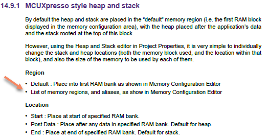

Information on MCUXpresso IDE's memory configuration, including placement of stack and the "standard" heap can be found in chapter 14, "Memory Configuration and Linker Scripts", of the MCUXpresso IDE v10.1 User Guide.
One thing to watch is that the heap referred to in the MCUXpresso IDE memory configuration is that used by the standard C library. This is generally not the heap that is used by FreeRTOS [in calls to pvPortMalloc() rather than the standard C malloc() routine].

I read the MCUXpresso IDE User Guide for 10.1.0 (Nov 14, 2017), specifically section 14.9.1 as it most closely resembles my configuration.
If I understand this correctly, when I change the Stack and Heap region to use my SDRAM bank, the memory bank order in the configuration editor should be disregarded.
However when I reorder my memory banks so that SDRAM is not the first RAM bank listed,
The project uses Stack (standard and FreeRTOS) and Heap from SRAM, not from SDRAM. Setting aside FreeRTOS stack location for now, why would the above config result in either standard Stack or Heap to be SRAM specific (ie: 0x2020xxxx range instead of 0x8000xxxx range)?

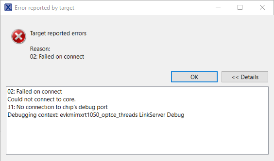

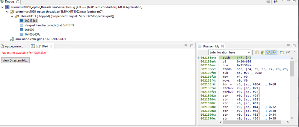

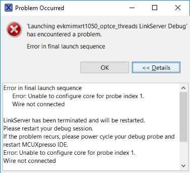

After this point nothing restored the project back to a running state. I restarted the MCUXpresso IDE several times and disconnected and reconnected the eval kit. Had to go thru a hyperflash mass erase procedure in order to redetect the DAPlink probe and reestablish a debug session.
After the mass erase, the DAPlink probe was identified again and the debug session resumed. I changed the order of the memory segment to have SDRAM follow hyperflash and changed stack/heap back to SDRAM. Entering debug mode did not cause a probe detect problem, but the main thread entered a SIGSTOP state.

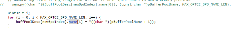

With the above configuration, running thru the project we encountered a hard fault. At first I incorrectly assumed this was another stack issue that was preventing allocation into SDRAM space, but single stepping thru project initialization confirmed that the hard fault came from a memcpy() call. The intent was to transfer a specific number of bytes from a const char * (flash string) into a global variable char array (also located in SDRAM). This same call worked fine when the SRAM sections resided between flash and SDRAM.
I changed the memcpy() call to a manual char transfer loop and that resolved the hard fault allowing the project to run completely from SDRAM resources. This is the code change:
where the name member of the buffPoolDesc[] structure is
and
I don't see the flaw in the memcpy() call syntax, and can't really see where memory type matters (ie: why FLASH to SRAM copy works, but FLASH to SDRAM copy throws a hard fault).
Either way, I now have a workaround for operating strictly out of SDRAM.

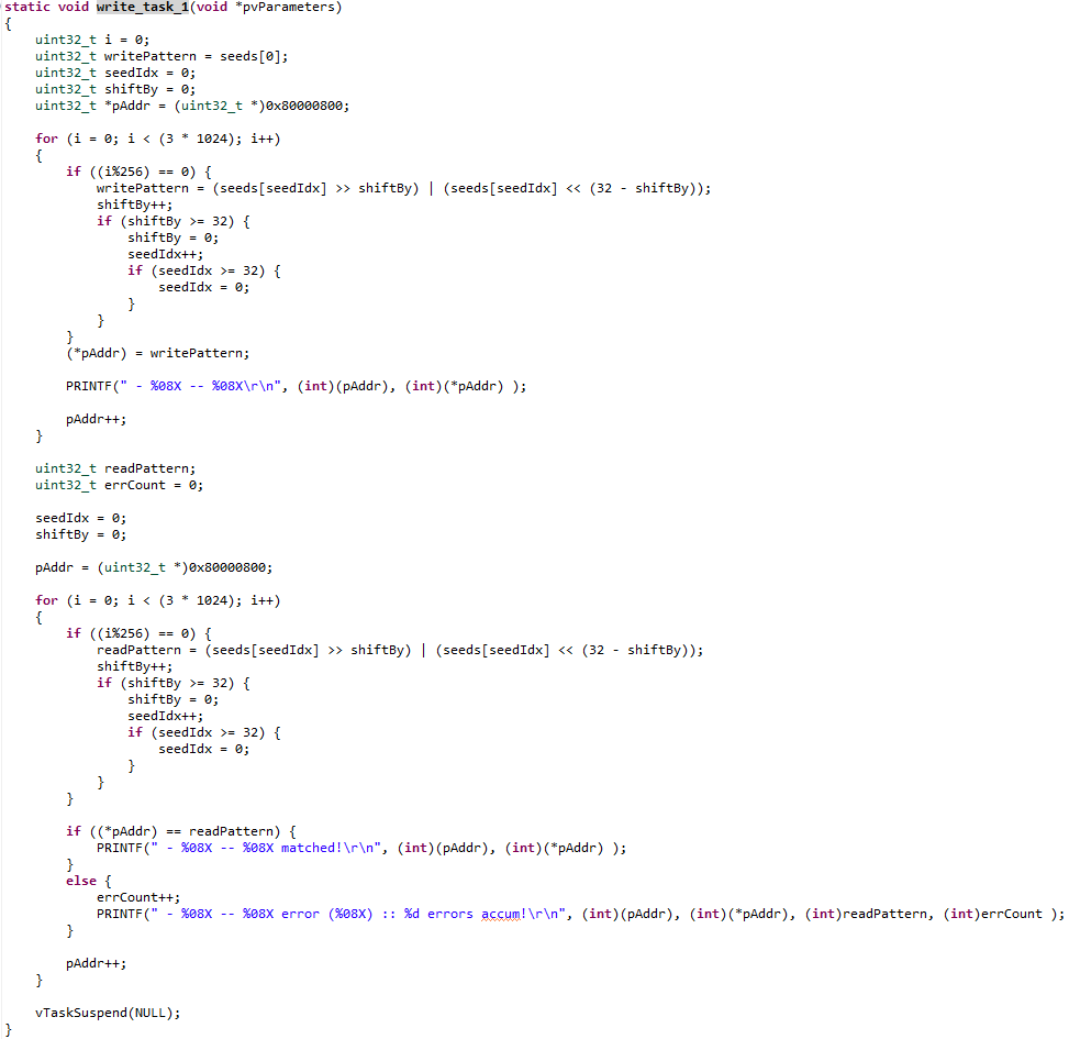

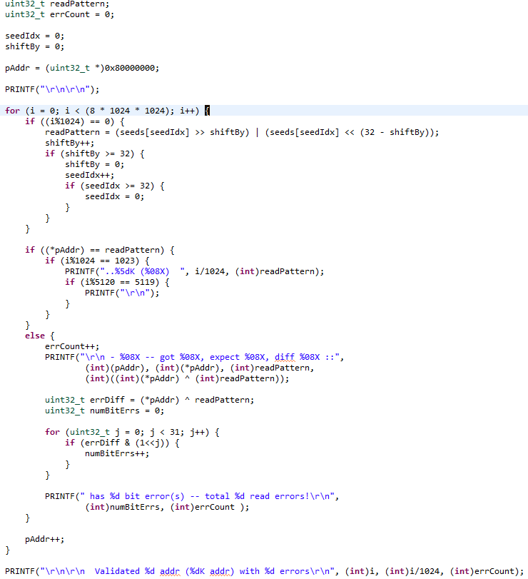

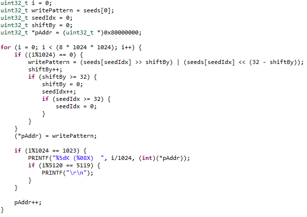

The test code running to perform the write part of the test:
The test code running to perform the read/verify part of the test:
Various runs thru this test code produce varied readback failures. A sample run output log is attached.

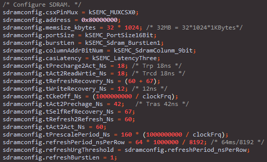

I am guessing that these bit errors are due to the current SDRAM timing configuration:

and modified the first write task to perform an SDRAM write/read/verify. Since the project ran from flash and used SRAM_DTC for stack/heap, I expected full access to the entire SDRAM space.
where this is declared as a global:
My first intent was to cycle thru various write patterns with frequent bit rotate operations performed periodically at odd times and run across the entire SDRAM memory space (32 MB), however I encountered readback issues with most tests that span SDRAM space in excess of 4KB.
The first write/read/verify of the first 4KB starting from 0x80000000 completed as expected.
The second test attempted to write 8KB (2 * 1024 uint32_t) starting from 0x80000000. It seems that the first 4KB were overwritten by the second 4KB write patterns.
The third test attempted to write 12KB (3 * 1024 uint32_t) starting from 0x80000000. Similar to the second attempt, it seems that only the first 4KB of SDRAM were accessed in the write phase.
The fourth test attempted to write 12KB starting from 0x80000800. Similar to the second attempt, only the first 4KB of SDRAM were accessed in the write phase.
I attached the output of the fourth test that reflects the test code snips included above.
