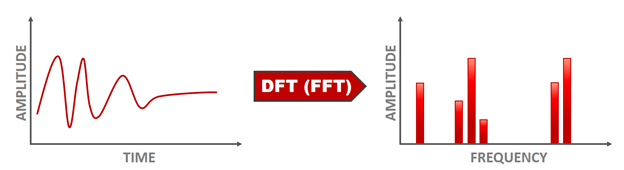

A Discrete Fourier Transform (DFT) converts a signal from time domain (left) into frequency domain (right). Every signal is made of one or multiple frequencies. If you consider a sound wave, then any sample of that sound wave has a set of frequencies with corresponding amplitudes that describe the overall sound wave.
Fourier demonstrated that you can take a set of sinusoids of different amplitudes and frequencies and by adding them together you can build up any signal - including a square one if needed.  A plot of frequency versus amplitude on an x-y graph of these sinusoids represents a frequency spectrum, or frequency domain plot.

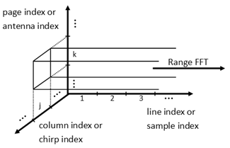

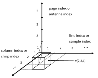

Data received by the SPT is made of demodulated signal and can be organized as a 3-dimensional array in the following way: there is a page for each antenna, and each page contains a matrix where each column contains the samples of a chirp.
In MATLAB we refer to the third dimension as pages. For example v(:,:,1) is the first page of v.
Fig. 1: SPT input data representation

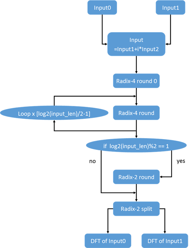

DATA PROCESSING FLOWCHART
Because the demodulated signal is real, the range FFT can be sped-up by computing the DFTs of two real signals at once. This is done by computing the DFT of the complex signal which has on the real part the first signal and on the imaginary part the second one, and then split the resulted DFT.
Fig. 3: FFT algorithm data processing flowchart

One radix-4 is done using the instruction RDX4, and one radix-2 round is done using the instruction RDX2. The first round of the FFT is a radix-4 round. In this round, because there is no need of twiddle factors, the instruction RDX4 lets you apply a window function on the input sequence. After we apply the remaining radix-4 rounds, if needed, we apply one radix-2 round. The last step is to find the DFTs of the real signals. This is done using the instruction RDX2.

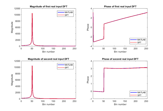

RESULTS
We verify the results using the FFT MATLAB function. In the image below the first column displays the magnitude of the two DFTs, and the second column displays their phases.
Fig. 5: Magnitude and Phase DFT of the real input signals
The script used in this example is attached below.
