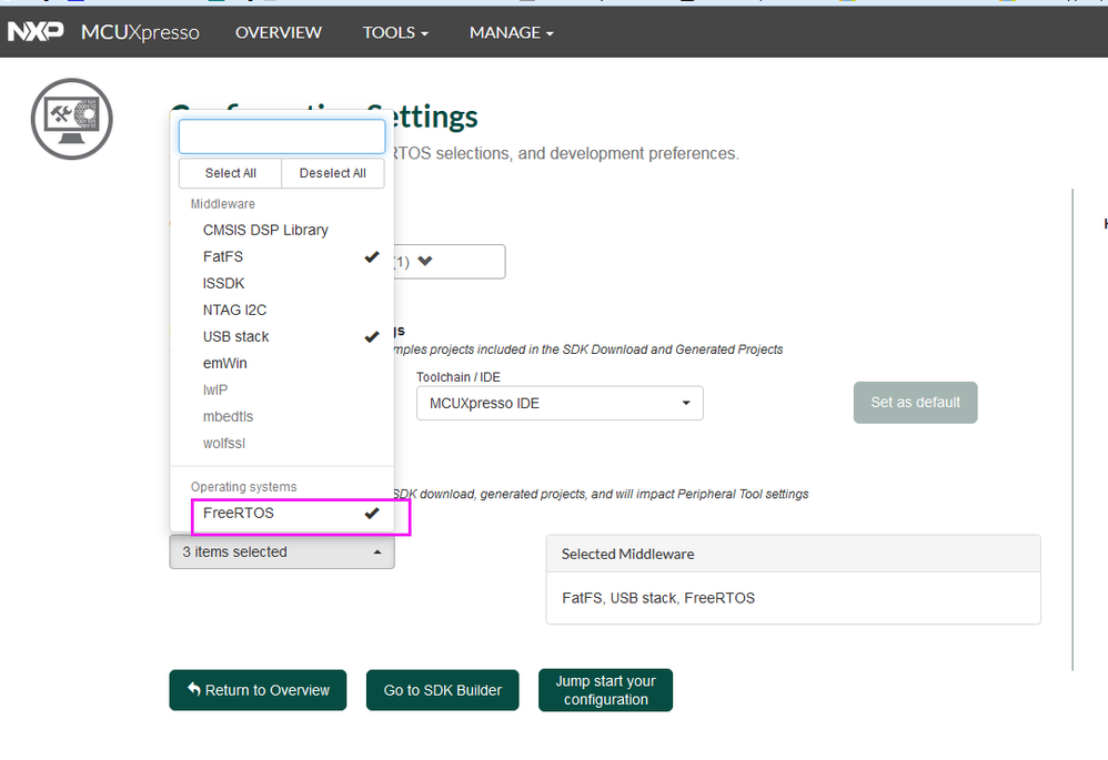

Firstly please select the "FreeRTOS" when download MCUXpresso SDK:

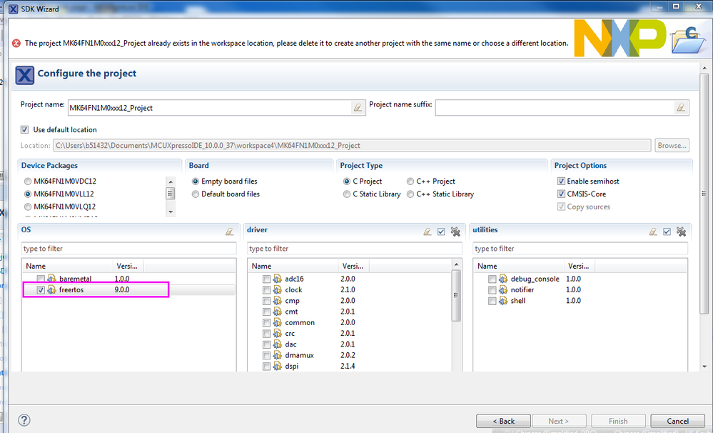

and then,please use the "New project..." in Quickstart Panel view to create new project:
Lastly, please choose "freertos" on OS view:
