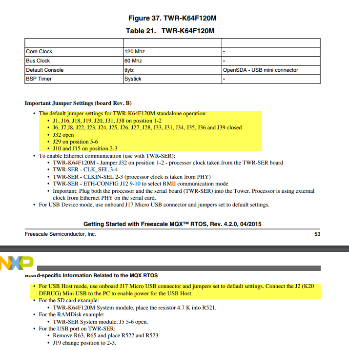

You can find the default jumper configurations in the FSL_MQX_getting_started.pdf
Please check the below recommendations:
Ensure that TWR-SER2 – J21 (USB_VBUS_EN) shunt is connected.
Ensure that the TWR kit is powered from the TWR-ELEV board and not from processor board.
The default jumper settings for TWR-K64F120M standalone operation:
• J1, J16, J18, J19, J20, J31, J38 on position 1-2
• J6, J7,J8, J22, J23, J24, J25, J26, J27, J28, J33, J31, J34, J35, J36 and J39 closed
• J32 open
• J29 on position 5-6
• J10 and J15 on position 2-3
For USB Device mode, use onboard J17 Micro USB connector and jumpers set to default settings
For USB Host mode, use onboard J17 Micro USB connector and jumpers set to default settings. Connect the J2 (K20 DEBUG) Mini USB to the PC to enable power for the USB Host.
