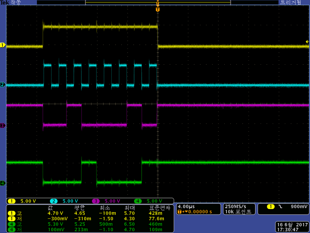

Hi. I have been made SPI slave activation but I have a problem.
I hope somebody helps me

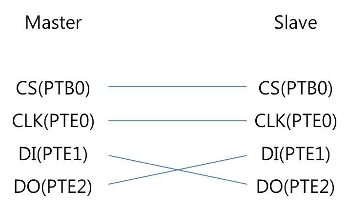

Master : S32K144 (64pin)
Slave : S32K144 (64pin)
Problem :

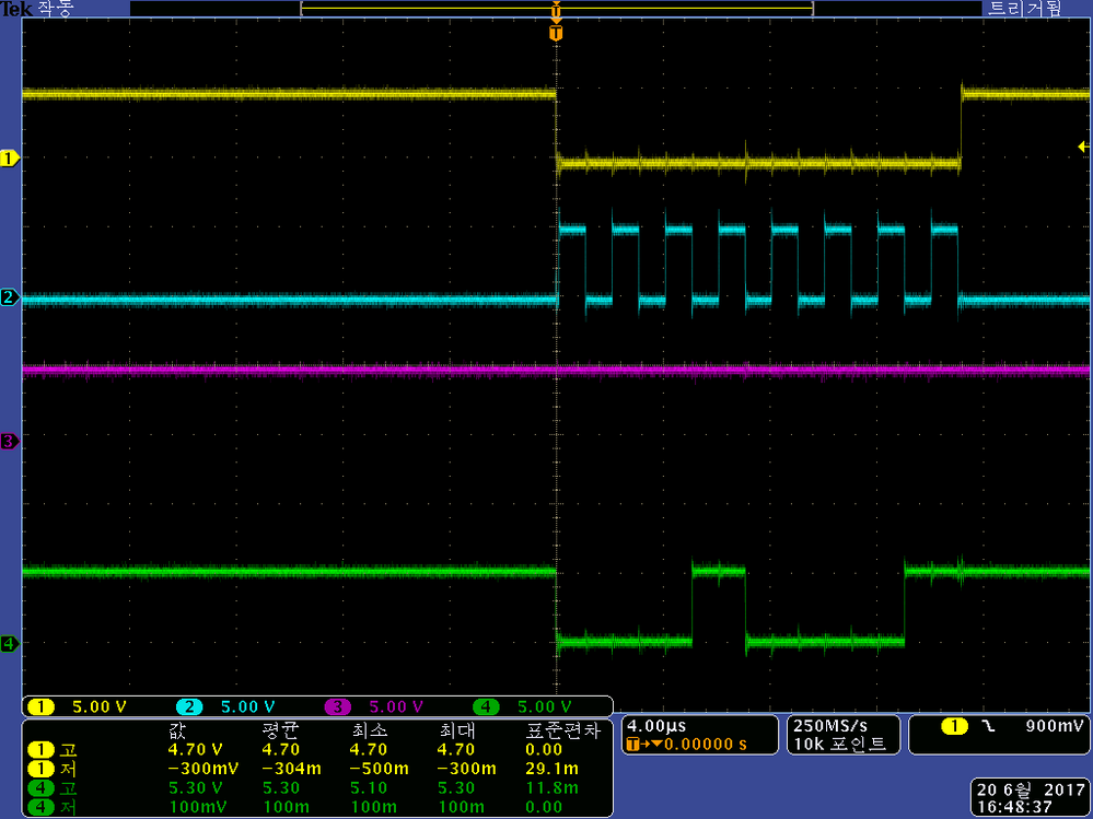

- In case Master's PCS polarity and Slave's PCS polarity are 'Active low', Slave does not transfer.
- Only in case both PCS polarity are 'Active high', Slave transfers correctly

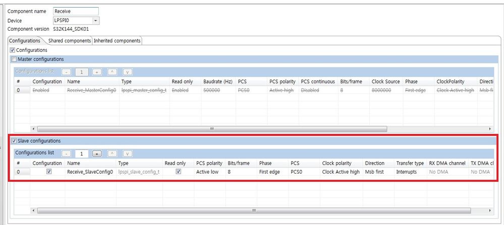

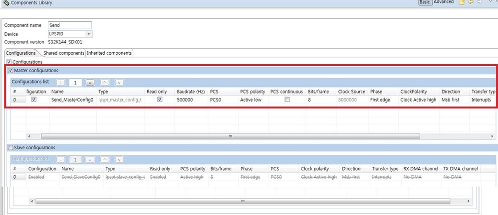

[Configuration]
- Master :  PCS polarity is Active low
- Slave : PCS polarity is Active low
[Picture]
- PCS polarity is Active low(yellow) and Slave does not transfer(pink)
- PCB polarity is Active high(yellow) and Slave trasfers(pink)
