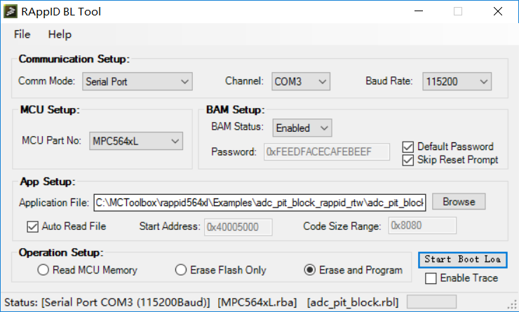

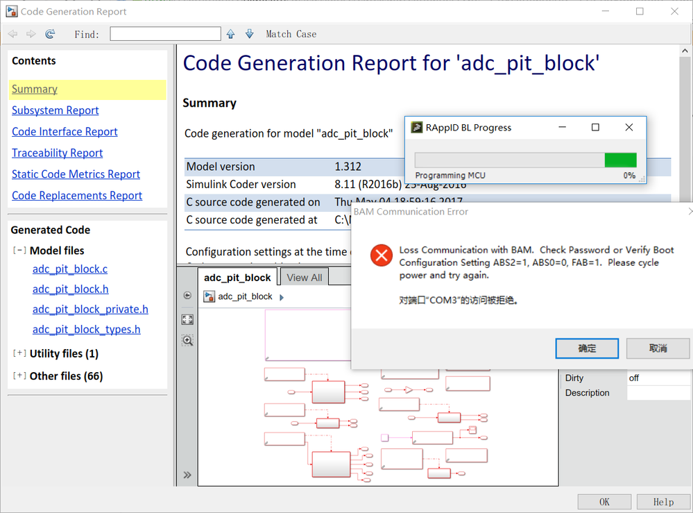

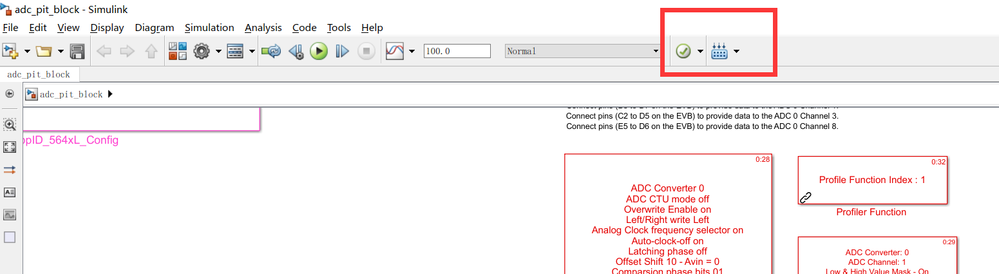

Daniel,i opened the MCToolbox\rappid564xl\Examples\adc_pit_block.mdl Simulink model,and click the Build model Button of simulink,as shown :
but there is an Error popup as shown below:
About the question i did as follow,but can not solve it,

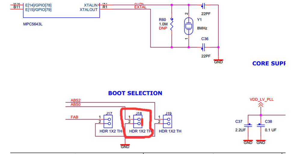

I made the J18 of the board in the short circuit state,shown as below:
and configure the RAppID BL Tool as below:
As discribtion above,and i can not solve it!
Help me!

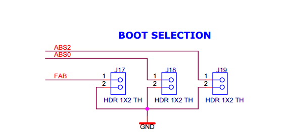

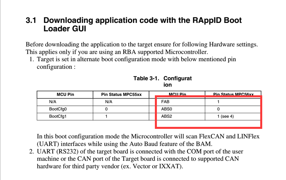

Firstly, asume you are using UART(serial boot via SCI), you should make sure your  on-board boot settings as FAB=1, and ABS0 = 0; ABS2 = 0 to make the MCU enter corresponding BAM mode; so you should leave J17 open and close both J18 and J19, at the same time, add a pull up(recommend 10K resistor ) circuit to FAB pad to drive the pin high for its reset default configuration is internal pull-down and no pull-up circuit on the board you are using.

In order to program the board via the serial protocol, the board needs to be have the BAM (boot assist module) active.

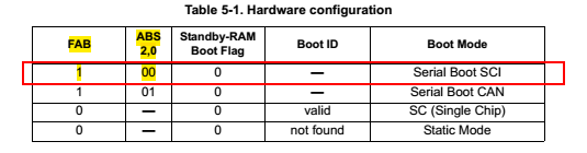

According with the MCP5643L Reference Manual - chapter 9.4.2 Boot Through BAM, the BAM is executed only on one or both of the following cases:
• serial boot mode has been selected by FABM pin;
• hardware hasn’t found a valid Boot ID in any flash memory boot locations
According with the board manual there are 3 Jumpers that controls this:
I would try only with J17 closed and the other 2 jumpers open.
Hope this helps!

   I'm sorry to tell you that I  try only with J17 closed and the other 2 jumpers open but i still do not down load the program!
I read the file named that RAppidBL_UserManual,shown that as below:pastedImage_2.png
                                                                                 fig 3

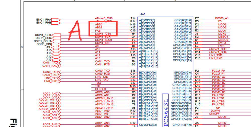

and the board circuit shown that :
                                                                               fig 4
and so i short the j18,but i found a phenomenon that i test the pin 1 of J18,pin 1 of j19 and pin 1 of J17 using  the multimeter  and the result shown that is zero. is not the high 1.i don't konw that is right or not?

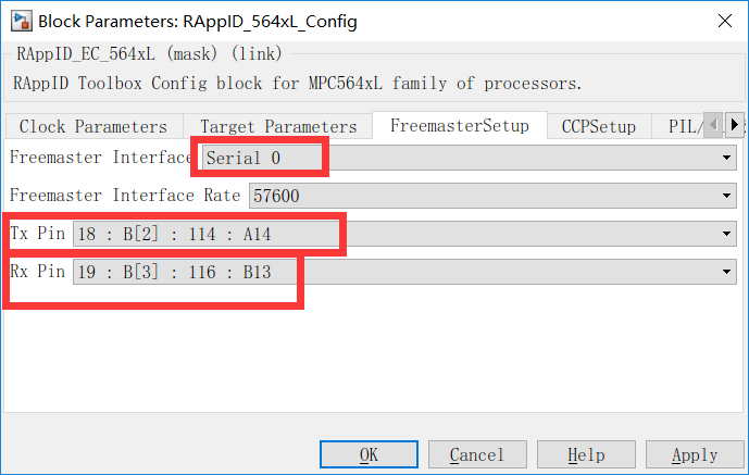

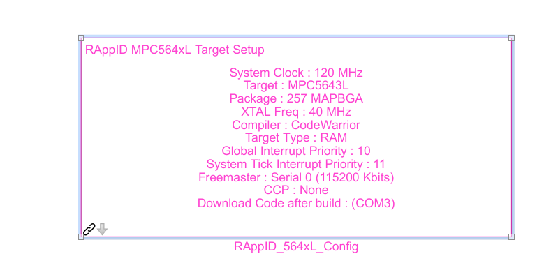

My simulink model configured as below:
                                                                                  fig 5

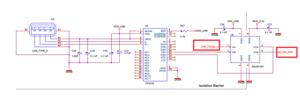

There is another doubt that as figure 6 shown below:
the LIN0_TXD and LIN0_RXD is Lin,Whether we should configure Freemaster to Lin rather than  to Serial 0?
                                                                            fig 6
Daniel,i can not solve it now!

Sorry - now is see that the pins are connected to the ground. So what i was trying to suggest earlier was to keep only J17 open (processor pin 1) while the other two shall be connected/zero ( to ground).
When you say you measured with the voltmeter and all shows 0 - even without pulling them to the ground - are you sure the processor is power on ?

These days i found some doubt:

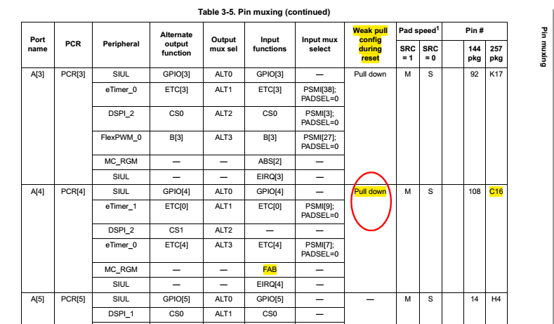

1#According to the tip,we should make ABS2 =1 ,FAB =1,and ABS0=0.
and i short J18 to ABS0=0,but ABS2 is not equal to 1,i thought the design of cricuit is not support the function,Whether is it design a pull cricuit in the board?
2# i wanna make sure a doubt that the configure is right or not?
 i do not know the TX_Pin and Rx_Pin is right or not?

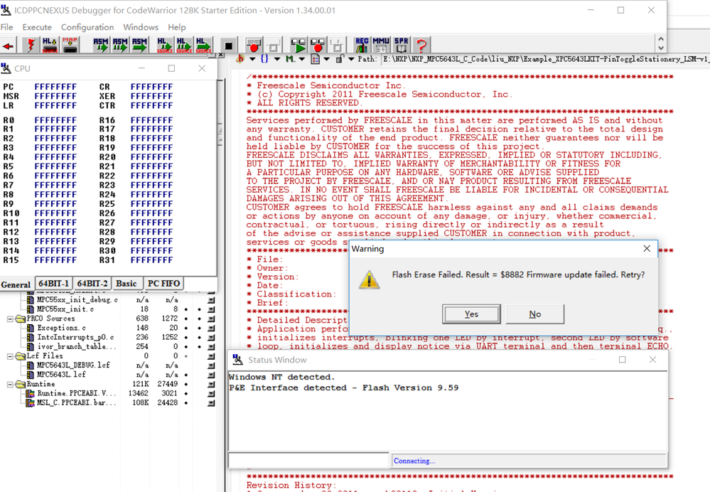

BTW,i used the C-code program ,down load the program,and popup another question as the below shown:
The C program come from the NXP official website.
4,704 Views

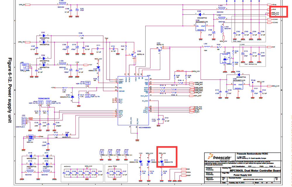

I read the cricuit:
 Whether the borad about the power supply has question!
