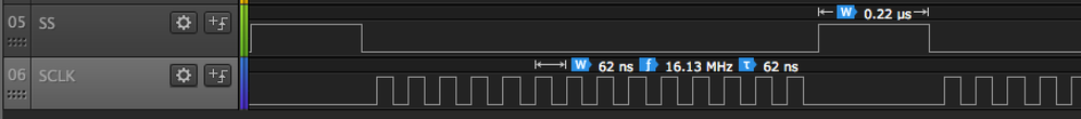

I'm using the i.MX7d with the linux 4.1.15 2.0.0 GA kernel, with a SPI peripheral connected to ECSPI3.  This is on the MX7D sabre board.  I need to have precise timing on the ECSPI transactions, and having read the reference manual and the datasheet it seems that it should be able to meet my needs.  However, I'm seeing unexpected results.

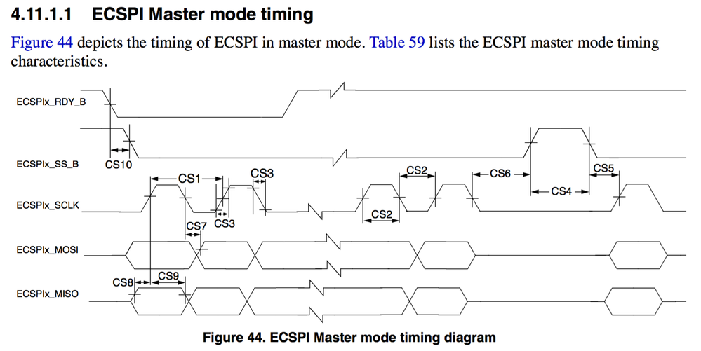

I need transactions (SS assertions) to occur at 1 MHz, and the SCLK to run at 16 MHz.  Burst width is set to 14 bits.  From the timing diagram in section 4.11.1.1 of the IMX7DCEC Electrical Characteristics document:

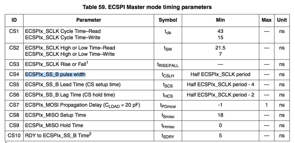

Given a SCLK at 16MHz, I would expect the CS4 time to be half a SCLK period as advertised, so CS4 should be approximately 32ns.  However, I see a much larger CS4 time: about 220ns:
What could be causing this discrepancy?  I am not using the PERIODREG register:

IC team confirmed that CS4 need 3.5 clk cycle after checking the RTL code , which conforms to the data from customer.

Thanks for the update.  Not great news, but at least we know what we're dealing with.  It would be good to issue some sort of update to the timing specification to reflect this fact.

datasheet CS4 time to be half a SCLK period depicts as "min". time,
it may be bigger depending on internal latencies caused, for example
linux. One can try with baremetal test to achieve better timings.
