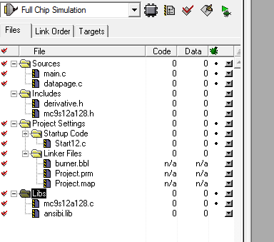

Is only main.c added in souce directory of code warrior?
4,129 Views
ZhangJennie
if you create a project with wizard, you will see besides main.c, there are also other .c, .h. .prm files. see it
Jennie Zhang

If i create different *.c files like RS232.c , spi.c  etc. is it necessary to add this to souce directory?
LIKE THIS
4,129 Views
ZhangJennie
the created files are customized files. Whether adding them to the project depends on customer side. I don't know what are those files for and what's inside.
For CW itself, it supports adding multi- files for build.
