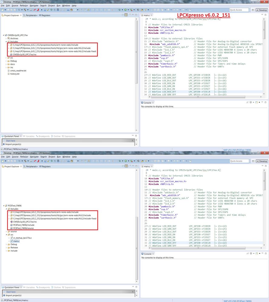

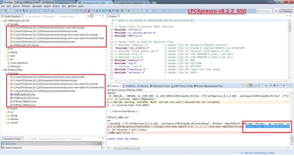

Hello again,
I tried to do all things to fix the "cannot find library" error but with no results.
I downloaded and installed the lastest version of LPCXpresso - v8.2.2_650. I opened simultaneously my previous (old) LPCXpresso - v6.0.2_151 (works great) and the new LPCXpresso v8.2.2_650 (cannot find the library CMSIS).
In both LPCXpressos I opened the same project and I opened "Menu -> Project -> Properties" and I compared 3 positions of settings:
- "C/C++ Build -> Settings -> Tool Settings -> MCU C Compiler -> Includes -> Includes paths (-I)" - in "Debug" and "Release" configuration,
- "C/C++ Build -> Settings -> Tool Settings -> MCU Linker -> Libraries -> Libraries (-I)" - in "Debug" and "Release" configuration,
- "C/C++ General -> Paths and Symbols -> Includes -> Additional Assembly  Source Files + Assembly + GNU C" - in "Debug" and "Release" configuration,
I compared this settings between old LPCXpresso (v6.0.2_151) and new LPCXpresso (v8.2.2_650) and I configured LPCXpresso v8.2.2_650 exactly in the same way as old LPCXpresso (v6.0.2_151) and it gives no results - "cannot find library CMSIS" sitll exists.
Below I send a screens of my old and new LPCXpresso software libraries in the projects.
01. Old LPCXpresso (v6.0.2_151):
02. New LPCXpresso (v8.2.2_650):

jakubpapuga-sza
Hi again,
I fixed the problem and the solution was not the settings in the Menu -> Project -> Properties -> so on so on... but there was some issue with teh core_cm3.c file: CMSISv1p30_LPC13xx cannot be build in LPCXpresso IDE ver.7 | www.LPCware.com
Please let me give some feedback answer about the "&" character in this file and differences between LPCXpresso 8.2 and the older one LPCXpresso 6.0.
Jakub
2,806 Views
avt
Afaik, it was a bug in that version of cmsis.it was fixed in v2 of cmsis. I guess you could say there was a bug in earlier versions of the compiler in that they did not report the bug/error.
