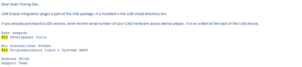

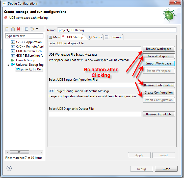

xuantruongdao
Hello Erwan,
Thank you so much, I did but cannot, may be my account is not be allowed.
I ask support team long time ago:
I don't have any hardware PLS as well as purchased UDE version. I need plugin only.
you  said you can debug and flash but I see a error in debug configuration - I think due to plugin or UDE not be installed in my machine.
Truong
