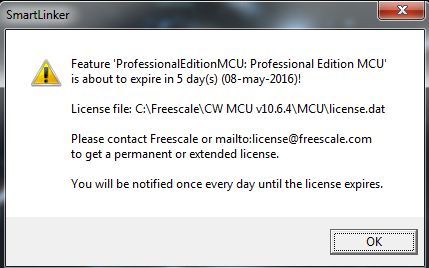

Here is a copy of the reminder (from today) which comes up EVERY TIME  I run the debugger after changing something in my source file (not "once every day" like the reminder says):

Helo BOB,
The "Professional" license in not free, so it have the reminder.
About the free license , you just need delete this professional license file "license.dat"(...\CW MCU v10.6\MCU),
the default version is Special version .

bpaehr
Thank you, Alice. That did the trick. Deleted the license.dat file. Now I no longer get the warnings.

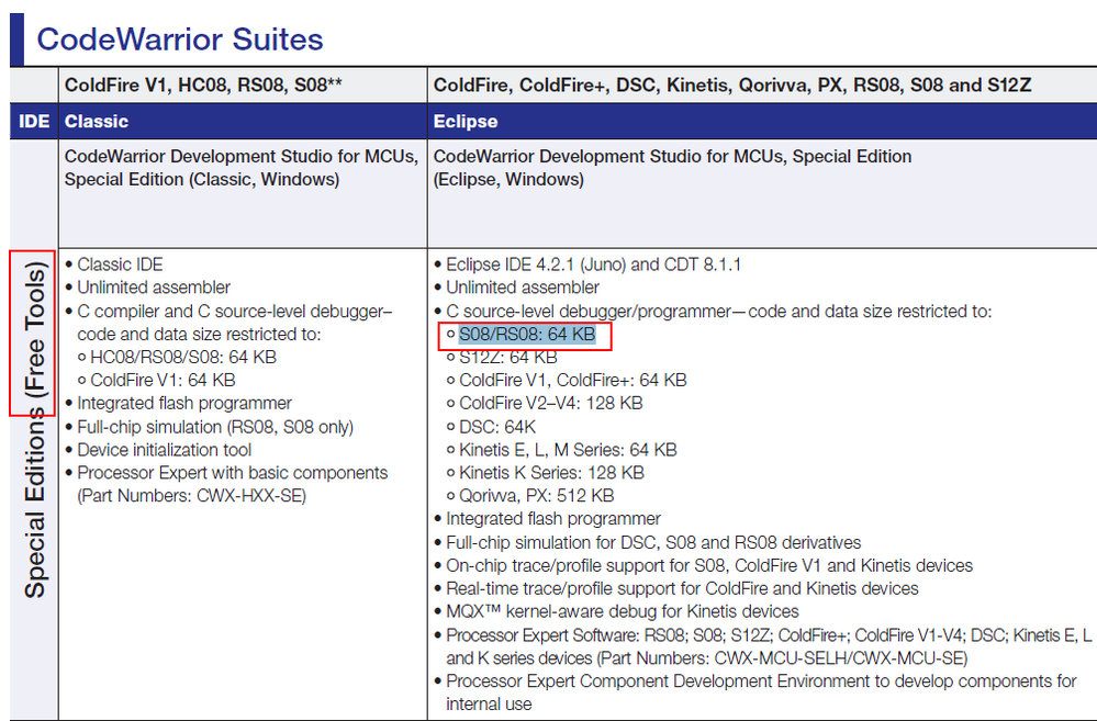

Hello BOB,
Yes, you can use the CW10.6.4, the Specail Editions is free,
You can download it at here CodeWarrior for Microcontrollers-Eclipse IDE|NXP

Hello BOB,
Sorry the last massage (i have delete) i send by mistake.
Yes, after you download the CW10.6.4, you can use it permanent by free ,
the 30 days meaning the evaluation license, you do not need care it .
For the Special license if free for permanent .
