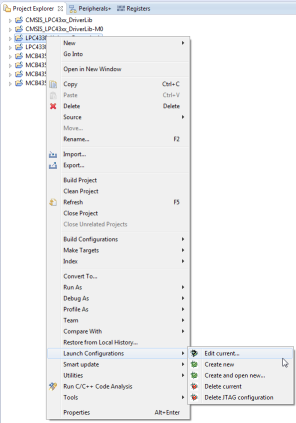

Select your project in the Project Explorer view and use right click to display the context sensitive menu.Now select the Launch Configuration entry:
If you have previously debugged the selected project, then select "Edit current...".If you have not previously debugged the selected project, then select "Create and edit new..."You will then see a new dialog box pop up...

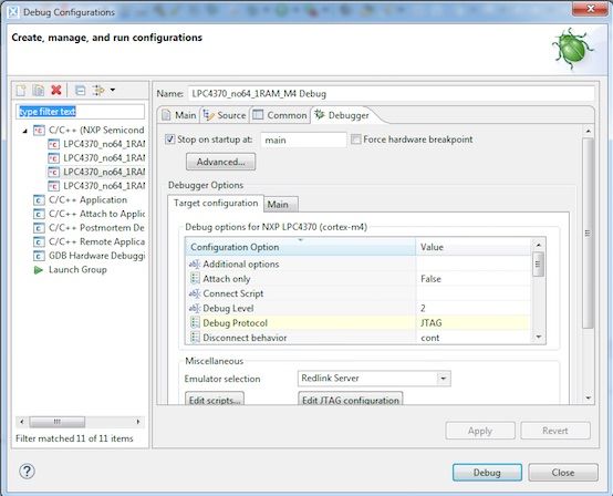

Ensure that the required project/build configuration is selected in the left hand column...

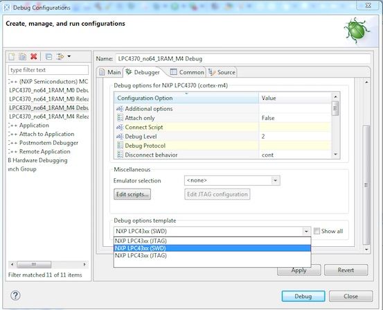

Then on the right hand side of the dialog, select the Debugger tab and then the Target configuration sub-tab (as shown in the above screenshot).
Then scroll to the bottom of the sub-tab, and change the "Debug options template" from the default "NXP LPC43xx (JTAG)" to "NXP LPC43xx (SWD)":
You can then click on the Debug button to save the change and start a new debug session using an SWD connection.
