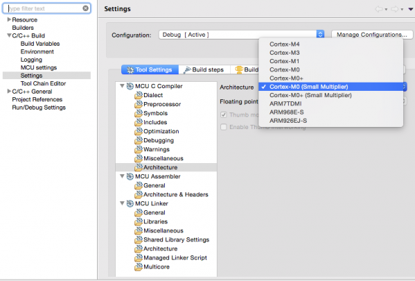

To turn this on, go to
Project -> Properties -> C/C++ Build -> Settings -> Tool Settings …
… -> MCU C Compiler -> Architecture
and select the small multiplier version of Cortex-M0:
