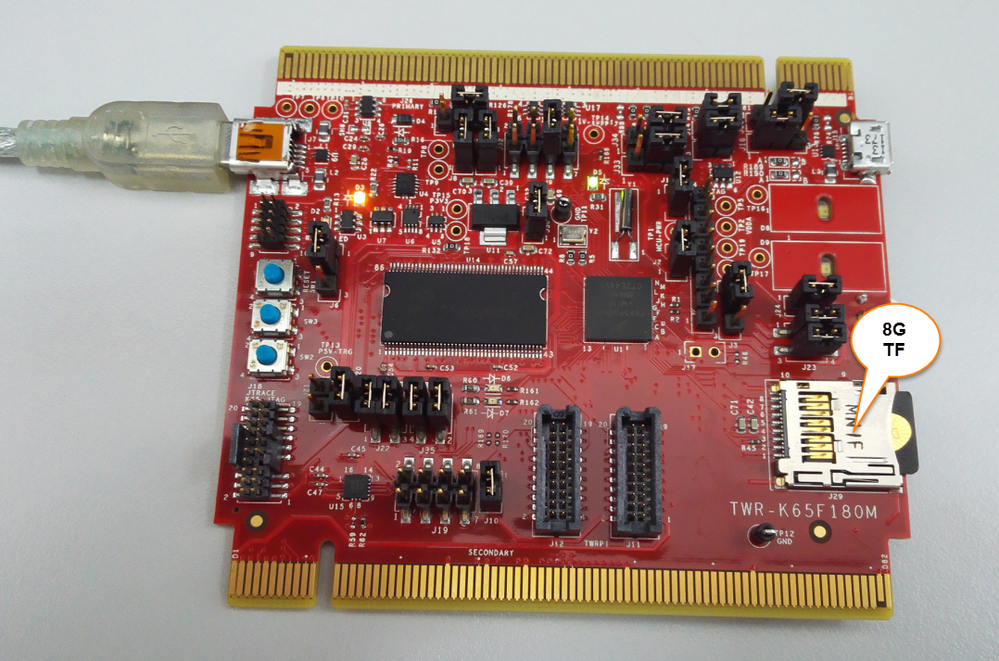

hi all, I have created a folder ".fsmd" my problem is i cant create a file witin that folder.but if i change its name to"fsmd" it could create a file within it. i dont know why..please help

im using SDCard
1,938件の閲覧回数
Hui_Ma
Today, I use TWR-K65F180M board do a test using KSDK V1.2 provides mfs example (located at C:\Freescale\KSDK_1.2.0\middleware\filesystem\mfs\examples\sdcard).
Below is the test hardware:
During my test, I find the mfs does support to create the folder with . prefix.
Below video shows the detailed test info (sorry for my input error command, I should input "type 3.txt" instead, which extend the video time).
Wish it helps.

Hi Hui_Ma,
   Thank you for  your kind reply. So we can create a file within a folder ( folder  name starts with "." (dot) ). is that your point?
1,938件の閲覧回数
Hui_Ma
Yes, I tried to create a folder name starting with a dot and could do copy/type file to/at this folder.
