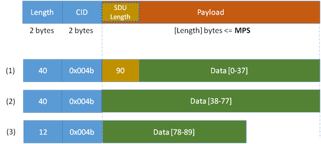

So MTU becomes 100 and MPS becomes 40. This means that a device can send SDUs of maximum 100 bytes, but these 100 bytes will be fragmented to fit into LE-frames of maximum 40 bytes payload.
An LE-frame contains:
  • The basic L2CAP header: Length (2 bytes) and CID (2 bytes)
  • Payload (length maximum equal to MPS)
When a large SDU is sent, the first LE-frame Payload starts with 2 bytes of SDU Length then follow the first MPS-2 bytes of SDU. Subsequent LE-frames each contain MPS bytes of SDU, while the last one may contain less than MPS bytes.
If device A from our example wants to send an SDU of 90 bytes, it would need 3 credits because the 90 bytes can be split in 3 LE-frames:
