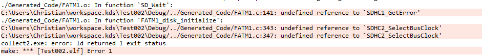

I tried to generate code for file operations on my FRDM-K64F board.
Unfortunately the component seems to be broken or not up-to-date.
Firstly I got these errors with PE:
20086_20086.png2015-02-21 22_48_41-Processor Expert - Test002_Sources_mqx_tasks.c - Kinetis Design Studio - C__User.png
I fixed this manually and got my generated code.
Next I implemented a code to open a file then I got these erros during compiling:
20087_20087.png2015-02-21 23_59_03-C_C   - Test002_Sources_mqx_tasks.c - Kinetis Design Studio - C__Users_Christian.png
I looked at the code and these functions are missing, but seem to be replaced by other ones.
Does anyone has a fixed version of this component or an easy way to use the sd card on this board?

Hi Chris,
indeed, the conditions were wrong. I have fixed it in the following commit:
https://github.com/ErichStyger/McuOnEclipse_PEx/commit/388b6af305847bb044b1522181f93a133fa42e5b
Let me know if you could apply that change on your side, or if you can wait for the next release of the components.

See the change in
You can do the same change in your file on your machine. It is here:
C:\ProgramData\Processor Expert\PEXDRV_PE5_3\Drivers\sw\FatFsMemSDHC.drv
Erich
