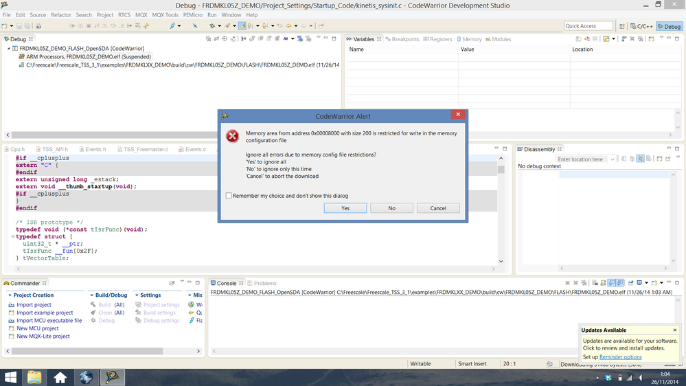

I'm using free CodeWarrior 10.6. I'm interested in the slider in this board so I downloaded the TSS3.1 software package.
I can import and build the example for the KL05Z-FRDM board but cannot run or debug it. See screenshot.
Am I doing something wrong? If you ignore this warning then you cannot debug since it gets stucked in a "asm" function.
We plan to use this MCU but first obviously I want to try them. In case this is a code size limitation issue, how can this example be made effectively lighter for me to try it?

Hello Kazola,
Sorry to reply you so late !
The  demo application overlaps the 32K flash size.
This mean that the TSS library is too big for this chip.
So You can disable some features of TSS library to reduce compiled code.
Hope it helps
Alice

Hi Kazola,
I have test that directly import the sample about FRDM-KL05Z, it error like yours , and I will check the reason as soon as possible .
And I will tell your the result .
Best Regards
Alice

Hello Kazola,
Hope it helps
Alice
