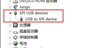

when I use SPIGen connect to FRDM-KL25Z,why it always fails?I promise that I have configurated all related softwares and drive.The pictures as follollws:

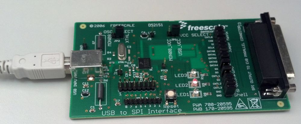

It needs to use KITUSBSPIEVME board (Evaluation Kit - USB-SPI interface), more detailed info, please check below link:
Evaluation Kit - USB-SPI interface, MC68HC908|Freescale
With KITUSBSPIEVME boards connects to USB cable, the [USB to SPI device] will be recognized as below:
Wish it helps.

When I connect to FRDM-KL25Z,Displays as follow:Q.png
It whether means I was failed?

I have tried to use FRDM-KL25Z board as USB to SPI device and it works.
Please check my connection for FRDM-KL25Z board and Windows device info:
Please re-program FRDM-KL25Z board with [UsbSpiDongleKL25Zv504] image and check again if it works or not.
