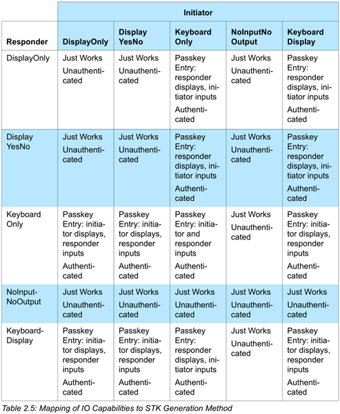

IO Capability
0x00
DisplayOnly
0x01
DisplayYesNo
0x02
KeyboardOnly
0x03
NoInpoutNoOutput
0x04
KeyboardDisplay
0x05-0xFF
Reserved

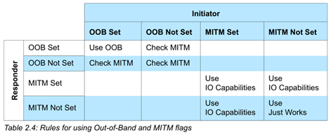

The OOB Data Flag is set to 1 if the application/device requires and supports exchanging data through an Out-of-band method.
The MITM flag is set in the AuthReq field if the Application requires Man-in-the-middle protection.

In this step the Temporary Key is generated. There are 3 ways of generating the TK in BLE (described below): Just Works, OOB, and Passkey Entry. The priority of these methods is the following: if both devices have set the OOB flag than the OOB method is used regardless of the other flags in the Pairing Request and Response. If the OOB flag is not set on at least one of the devices then the MITM flag is checked. If both devices have not set the MITM flag then the just works method is chosen (IO capabilities are ignored), else the pairing algorithm is chosen based on the IO Capabilities.

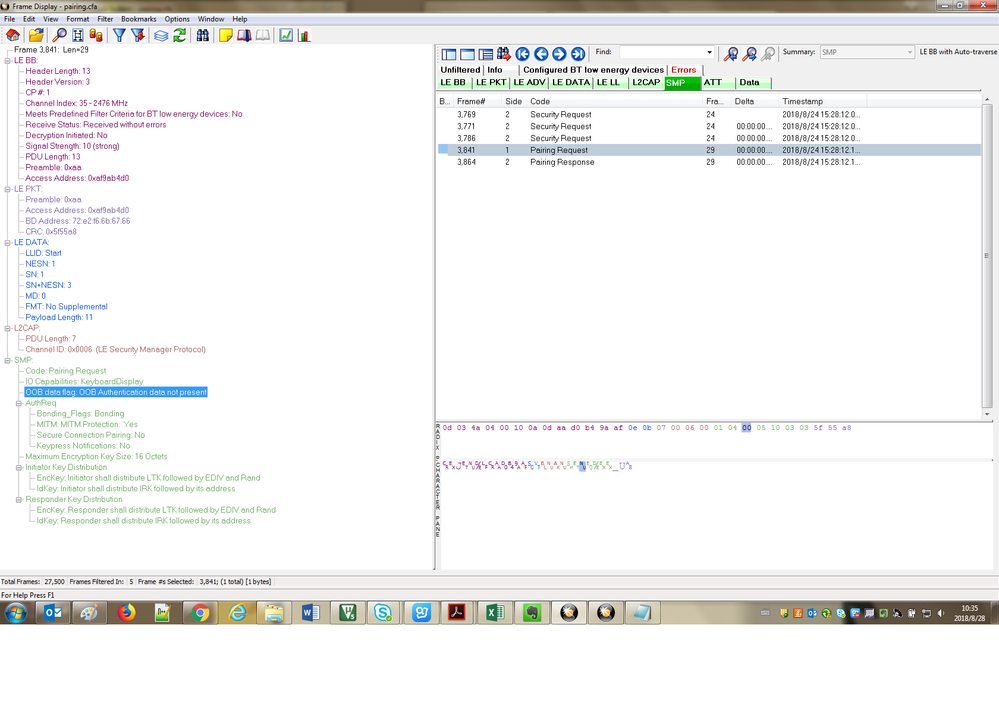

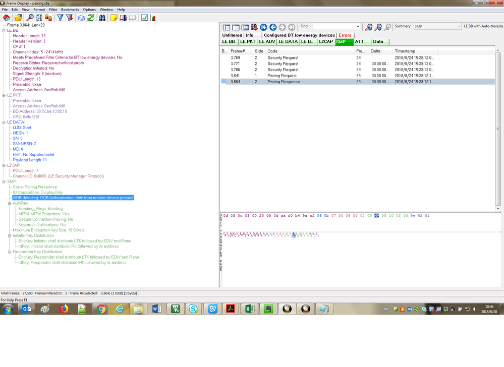

Hello Sir,
I face an problem in BLE OOB with NFC
If I use the OOB-NFC to do BLE paring , In the pairing request, I see the "OOB data flag: OOB Authentication data not present". The request is sent by an android phone. What's the meaning of it ? What should I do to make the OOB data is present.
Thanks, and waiting for you response.
