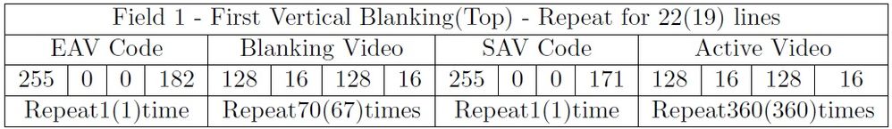

I am having diffuclty setting the full horizontal blanking period of BT1120-1080i into the IPU.  For BT1120-1080i, the horizontal blanking requires 2 bytes.  It appears that only the lower byte is getting set.  For example, 1080i60 horizontal blanking is 280 (0x118).  I only read 0x18 on my encoder chip, the upper byte is missing.  Likewise for 1080i50 the value is 720 (0x2D0) but I only get 0xD0.  Both NTSC and PAL only require a single byte to hold the blanking period, which would explain why those modes work and HD does not.
Can you tell me the address to the register that is holding the horizontal blanking period?  Is the register large enough to hold 2 bytes of data?

Where did you set the blanking data? In ipu_disp.c, function _ipu_dc_setup_bt656_interlaced(), the blanking data will be sent on 16 bits data lines, and they are fixed 0x1080:
if(is_bt1120) {
  _ipu_dc_write_tmpl(ipu, microcode_addr, WRG, (0x1080 << (di_msb - 15)), 0, 0, 0, DI_BT656_SYNC_BASECLK, 0, 0, 0);

You can reference to the BT656 line data format, that 0x1080 is the Blanking Video data. For 8 bits BT656 interface, it needs 4 clocks for each pixel; but for 16 bits BT1120 interface, it needs 2 clocks for each pixel.

Thank you for that information.  It is helpful, but I do not think it addresses the actual problem.  It appears that the issue is not with the blanking data, but the blanking timing loop_N_times.  In the function _ipu_dc_setup_bt656_interlaced, the horizontal blanking period is getting passed in to loop_N_times. Then loop_N_times is getting passed to _ipu_dc_write_tmpl case BMA.  Inside case BMA, loop_N_times is shifted left by five then written into a register.  What is the physical address that loop_N_times is getting written into?  I am concerned that the second byte is sitting on an illegal boundary, and is therefore getting corrupted/lost.
case BMA:
   reg = sync;
   reg |= (operand << 5);
    _ipu_dc_tmpl_write(ipu, reg, word*8);
For 1080i60, I expect to see 2200 - 280 = 1920.  What I am instead seeing is 2200 - 24 = 2176.  The correct horizontal blanking period of 280 (0x118) is loosing its most significant byte, which results in 24 (0x18) being sent to my encoder chip.  The same is true for 1080i50, where 720 (0x2D0) becomes 208 (0xD0).  Neither NTSC or PAL require a second byte to set the correct value, and they do work correctly on my hardware.   Am I on the right track here, or am I way off base?

qiang_li-mpu_se
Hi Josh, the issue should be caused by the BMA command, the N "loop_N_times" parameter is a 8 bits value, bit 5~12, so its MAX value is 255.
I will update the IPU microcode to fix this issue. Thanks for your loading to find it.

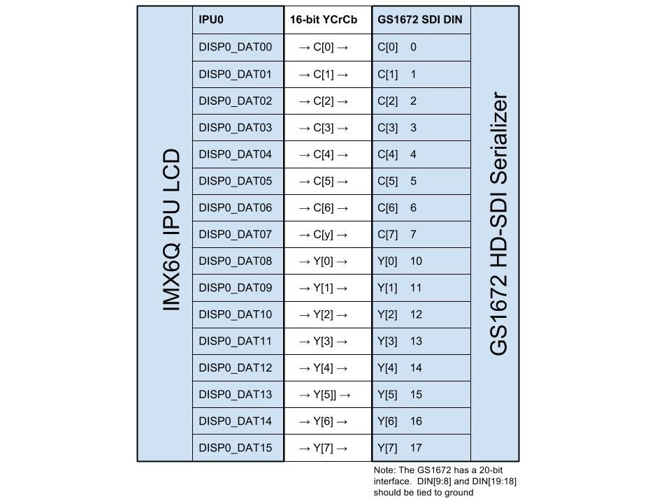

IMX6 Disp -> SDI Chip pinout:
For the record, I have BT1120-PAL working flawlessly, and BT1120-NTSC functions but is distorted.  When I switch to 1080I50 and 60, the pixel clock adjusts correctly and the sdi chip can lock to it, but the data received is incorrect.  I am unable to determine if the issue is with the bt1120 patch, a configuration of the imx6, configuration of the sdi chip or a hardware problem.
