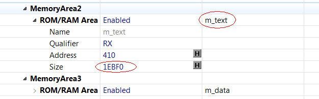

LuisCasado
First, you have to reserve some Flash pages for data storage. Do that in the CPU Build Options, Reduce the Flash for code, for example :

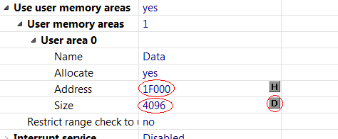

Then, configure those pages to be used by Flash component:

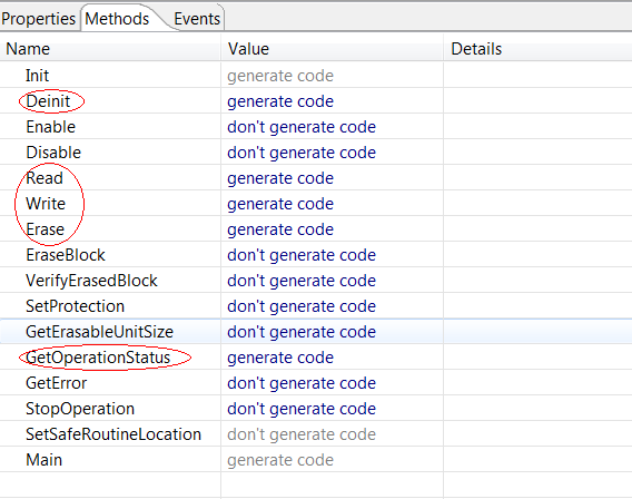

Then, enable the Flash methods you need:

lander
I'm not able to change the section "User memory areas", it's grey and will not let me make "Use user memory areas" to yes. I did step one, is there something else I'm missing?
