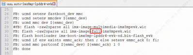

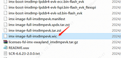

      The reason is that uuu.auto or uuu.auto-xxx can't match the firmware provided by prebuilt, you need to modify.

Thanks. That does seem to be the fix.
IDK what you mean by "uuu.auto or uuu.auto-xxx can't match the firmware provided by prebuilt". I agree that it doesn't match. But I see no reason that it can't. In fact, it should. I opened a ticket at NXP to fix it. ... not that I'm expecting it to get fixed
I actually found the issue myself yesterday. By debugging uuu I determined the name of the file it could not find, and then looked in uuu.auto since I had learned the same day that that is the config file for uuu. Thing is, uuu should report the name of the file it cannot find. It's lazy (of the program and its programmer) to not report the file name.
