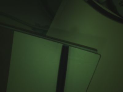

Issue Description: We are using the following GStreamer pipeline to capture a single frame from the Hi-846 camera:
gst-launch-1.0 v4l2src device=/dev/video0 num-buffers=1 ! "video/x-bayer,format=grbg,width=3264,height=2448" ! bayer2rgb ! videoconvert ! jpegenc ! filesink location=/tmp/output_gst_ori.jpg

The pipeline successfully captures a photo, but the image exhibits a noticeable greenish tint. The scene includes a white notebook as the background and a red pen as the subject, both of which appear distorted in color. I will attach the captured photo (output_gst_ori.jpg) to this email for your reference.

It appears since the Hi-846 outputs 10-bit Bayer data and your current pipeline uses a generic bayer2rgb conversion without any calibration, the resulting RGB image often lacks accurate color fidelity.
You can try using videobalance in your pipeline:
gst-launch-1.0 v4l2src device=/dev/video0 num-buffers=1 \
! "video/x-bayer,format=grbg,width=3264,height=2448" \
! bayer2rgb \
! videoconvert \
! videobalance red=1.2 green=1.0 blue=1.6 \
! jpegenc \
! filesink location=/tmp/output_corrected.jpg
Adjust the values as necessary.
