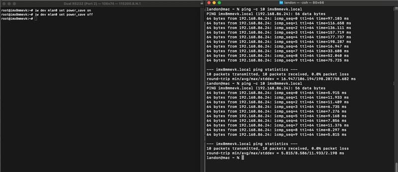

Replying here for documentation:
It seems that this is caused by power saving mode being on by default on the 88w8987 and 8M Mini EVK.
Turn off power saving mode with:
iw dev mlan0 set power_save off
Landon

I can confirm the following command solved the problem.
Thanks Landon!
