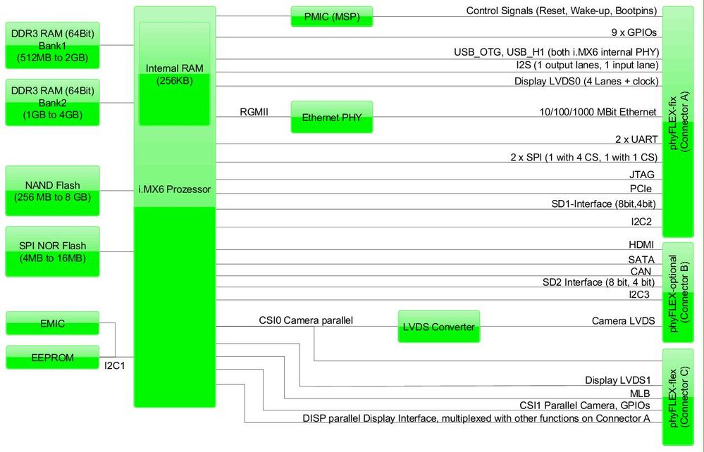

Freescales i.MX 6 family provides product developers with the computing power of consumer applications for use in the industrial and automotive sector.
Rich Industrial Interfaces
i.MX 6 processors offer a wide range of interfaces that render these devices suitable for industrial use. These include Gigabit Ethernet, PCI Express and SATA 2 that are integrated into the processor. The two Flex CAN interfaces make i.MX 6 processors specifically suitable for automotive as well as industrial applications. All interfaces provide an I/O voltage of 3.3 V. Accordingly, in most use cases there is no extensive signallevel adjustments are needed for design-in of the processor, thus simplifying peripheral circuitry design.
The phyFLEX-i.MX 6 System on Module Highlights
The i.MX 6 controller (Cortex-A9) can internally comprise one, two or four cores.This means that the...
  • i.MX6 Single, Dual, Quad core
  • Up to 1,2 GHz / core
  • VPU, IPUv3H, GPU2Dv2, OpenVG 1.2
  • Up to 4 GB DDR3 / 16 GB NAND
  • SD/SDIO/MMC
  • USB 2.0 OTG and Host
  • PCIe, SATA II
  • CAN, UART, SPI, I2C, I2S
  • Camera interface
  • Up to 4 displays + HDMI
  • Linux and Compact 7 BSPs

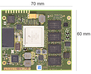

phyFLEX-i.MX6 interfaces are routed to our high-density PCB interconnects on the underside of the SOM. Design the mating connectors on your carrier board.
