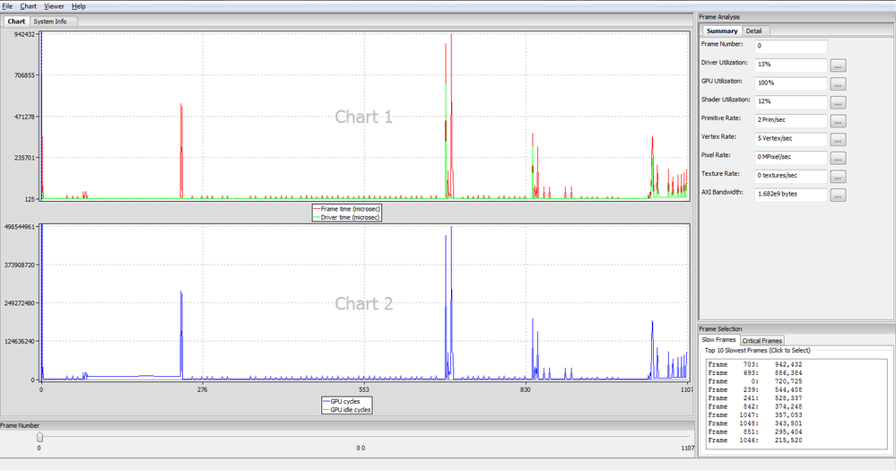

How To Be Sure That My Application Using GPU:
If you have a look at https://community.nxp.com/thread/324670 you can profile a graphical application and investigate if it uses GPU or not, also you can measure the performance and analyze the application by vAnalyzer.
According to the link I’ve mentioned that’s enough to set galcore.gpuProfiler=1 in uboot and then check the /sys/module/galcore/parameters/gpuProfiler   file (read the file by cat, vi, nano, etc.) if the output is 1 all things is done in a right way the final step is that exporting some environment variables :
export VIV_PROFILE=1
export VP_OUTPUT=sample.vpd
export VP_FRAME_NUM=1000
export VP_SYNC_MODE=1
VIV_PROFILE[0,1,2,3], VP_OUTPUT[any string], VP_FRAME_NUM[1,N], VP_SYNC_MODE[0,1]
Note: VIV_PROFILE[0] Disable vProfiler (default), VIV_PROFILE [1] Enable vProfiler, VIV_PROFILE [2] Control via application call, VIV_PROFILE [3]Allows control over which frames to profile with vProfiler by VP_FRAME_START and VP_FRAME_END.
If application uses GPU smaple.vpd file will create if not there isn't any vpd file.
