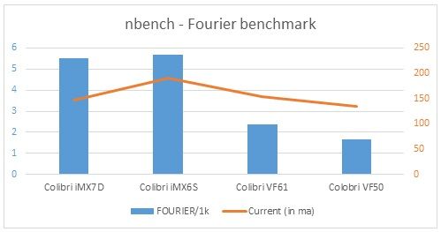

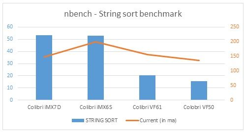

Toradex's internal benchmarks prove the effectiveness of the new architecture used for i.MX 7 processors. While the performance is comparable to the very successful i.MX 6Solo processor (ARM® Cortex-A9 1GHz) SoC, the power consumption in operating mode is in the range of the Colibri VF61 (ARM® Cortex-A5 500MHz) or less than 75% of the power consumption of i.MX 6Solo. When looking at the standby mode, i.MX 7 requires even less than a third compared to the power consumption of i.MX 6Solo.
Nbech Graph 1.jpgNbech Graph 2.jpg                                                                                                      *Results are based on nbench benchmarking, which uses a single-core, so performance & power consumption figures
                                                                                                                are comparable between dual-core i.MX 7Dual and single-core SoCs such as i.MX 6Solo, VF61 & VF50
