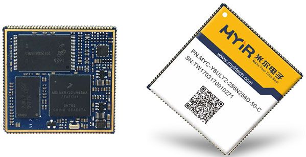

This document is an overview file for introducing MYIR's CPU Module MYC-Y6ULX, which is starting at only $18, delivered with shield cover and powered by NXP i.MX 6UltraLite / 6ULL ARM Cortex-A7 processor. It is part of a MYD-Y6ULX development board, capable of running Linux and supports -40 to 85°C working temperature for industrial embedded applications.

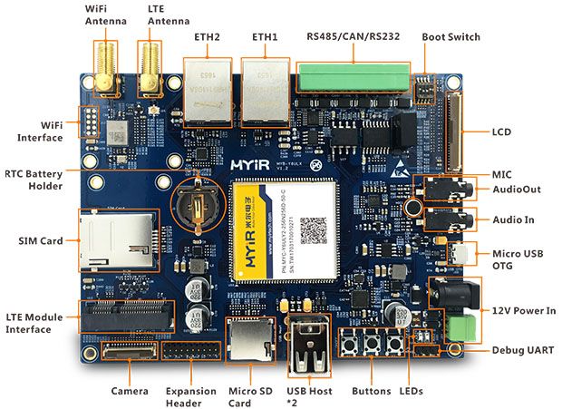

The MYC-Y6ULX CPU Module has a compact sizeof 37mm by 39mm, carrying out as many as peripheral signals and IOs through 1.0mm pitch 140-pin stamp hole expansion interface. It is integrated with 528 MHz i.MX 6UltraLite / i.MX 6ULL processor, 256MB DDR3, 256MB Nand Flash (4GB eMMC Flash is optional) and Ethernet PHY. It is populated on MYD-Y6ULX development board base board as the core controller board, thus rich peripherals and interfaces have been extended through connectors and headers to the base board like Serial ports, USB, Ethernet, CAN, Micro SD card, WiFi module, LCD/Touch screen, Camera, Audio as well as a Mini PCIe interface for optional USB based 4G LTE module. The MYD-Y6ULX is a versatile platform and solid reference design delivered with necessary cable accessories and detailed documentations ideal for prototype and evaluation based on i.MX 6UL/6ULL solutions.
