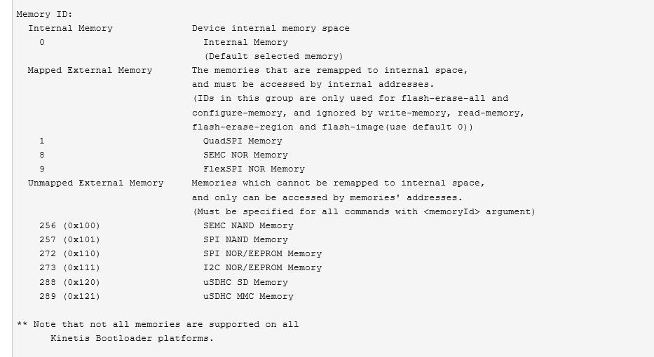

I am studying the blhost command,
Form user manual
pastedImage_4.png and google on
痞子衡嵌入式:恩智浦i.MX RTxxx系列MCU启动那些事(3)- Serial ISP模式(blhost)_痞子衡嵌入式-CSDN博客_imxrt blhost
I have a question,
Where can I find the MemoryID information for RT1015?

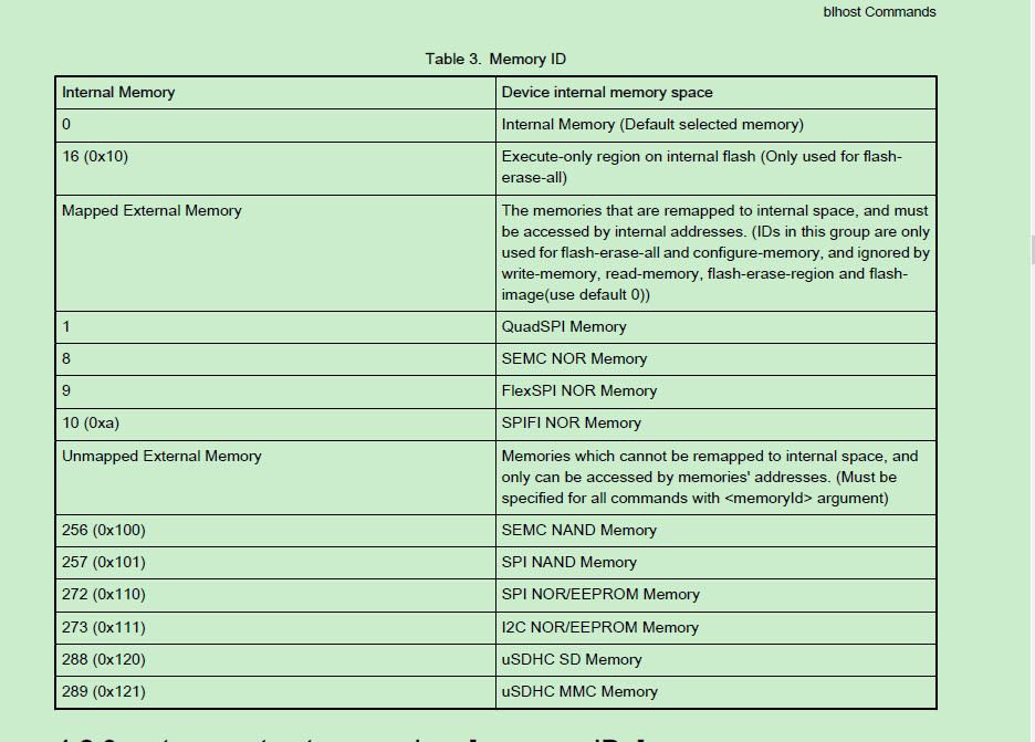

Hi Ken Su ,
  If you are using RT1015, please refer to this blog:
https://www.cnblogs.com/henjay724/p/9098577.html
In fact, if you download the SDK doc, and the middleware also select the mcuboot, you can find it in the sdk doc document: blhost user's guide.pdf
Wish it helps you!

I download the SDK Doc, and the blhost User's Guide(Rev. 6, 12/2019) have memoryID information.
PS:
My current blhost User's Guide doc is Rev 4, 05/2018.
No memoryID information in this rev.
Ken

Hi Ken Su ,
  So, new version document is very important.
  In the near future(maybe next month), RT1015 will have the new SDK2.8.0, so, after that time, please also update your SDK version to the newest one!
