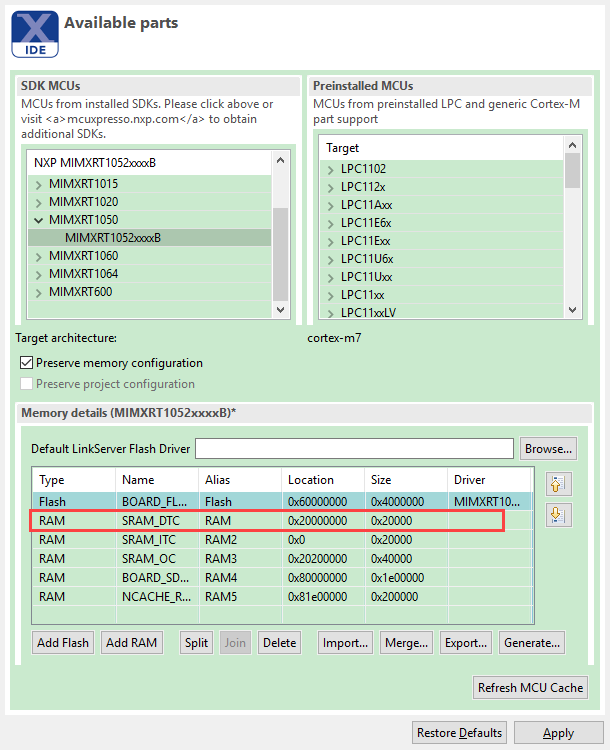

I have a question regarding the linker option: "Link application to RAM" when using Managed Linker Scripts in MCUXpresso IDE (v10.3.1 [Build 2233] [2019-02-20] Manifest for SDK SDK_2.x_EVKB-IMXRT1050 V 2.5.1).
When i look at the resulting map file i can see that the resulting image starts at 0x20000000 which is the beginning of the DTCM-RAM.
In the Reference Manual it says under "9.6.1.3 FlexSPI NOR boot flow chart" (the image is loaded from a FlexSPI NOR-Flash)
that the image is copied to the OCRAM.
So my questions are:
1. Why is the application liked to the DTCM and not to OCRAM?
2. How exactly does the ROM-code figure out that the image is XIP?
Thank you very much,
Johann

Hello Johann,
When you select the option Link application to Ram in MCUXpresso IDE, the IDE will put the application in the first RAM block that if fines, which is the DTCM. You can easily modify this on the MCU settings of the project. By default you have the following settings:
If you want to place the application on the OCRAM memory you will need to select it and send it all the way below the BOARD_FLASH, like shown below:
This is determined by the address that you use when building your application. If when you compile the image you select the FlexSPI address then it detects that the image is XIP, but when you select the internal RAM then it detects that it's non XIP because the address is not from the FlexSPI memory mapped.
Victor
