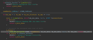

I have custom board with RT1176. In my application, i am decrypting the encrypted bin file. If i read all encrypted bin file at once and send the datas to decryption functions, it works correctly but as you can guess i have to use lots of ram space.
I change my code to decrease the usage of ram. I am reading data 256 bytes and after that decrypting the data for almost 200 times. When i debug my code, decryption process is done only one time(first cycle) successfully. After that, decryption process is not working.
What am i doing wrong? Can you help me?

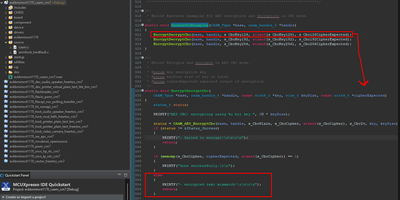

Also i realized something new for me. I copied&pasted AesCbcExample functions, variables, input vector, etc. inside of the caam_cm7 sdk example and debuged it. It did not work successfully. Encrypted file missmatched with expected encrypted file.
Is this example works correctly?

- Yes, code that shared is SDK Demo code. For second problem, you can run the demo directly. I got errors while debugging as i mentioned above.
- I have 50 Kb encrypted bin file and i want to decrypte every cycle 256 bytes of that file untill 50Kb. Yes, as you said first time decryption process works correctly.
- I tried to modify caam.c simply as in my project. You can understand what i am trying to do. I did not test the code cause i do not have EVK-Board. I hope it works.
- If it is not enought for you, i want to modify caam.c as you wish but i am reading bin file from USB so i have to modify whole project. I also do not have permission to share my project. If you can write a scenario about how you will read data etc., i can try to modify. I can take a screen record while debugging and share with you. Is it fine?

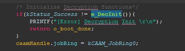

In my code:
1) I set CAAM_Init().
Bkaya_0-1711440799687.pngBkaya_0-1711440799687.pngBkaya_1-1711440837393.pngBkaya_1-1711440837393.png

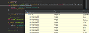

2) I am reading encrypted bin file 256 bytes, decrypting it by using CAAM_AES_DecryptCbc() function and writing the data to flash.
First time of the loop, decyption process done successfully.
Bkaya_3-1711441149958.pngBkaya_3-1711441149958.pngBkaya_4-1711441211334.pngBkaya_4-1711441211334.png

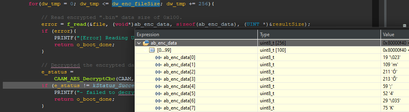

Second time of the loop, decryption process did not work but it returned success. After this point to end of the for loop, all decryption process will return 0s. Hence, i can not write correct main application to the flash.
Bkaya_5-1711441341514.pngBkaya_5-1711441341514.pngBkaya_6-1711441381302.pngBkaya_6-1711441381302.png
Therefore, i think i am missing some important things. If you ask me, what did i do to solve this issue?
