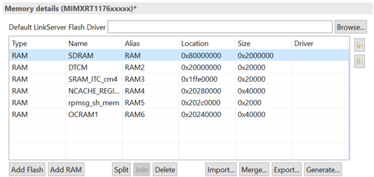

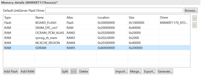

In CM7 project, add SDRAM space in properties->MCU settings->Memory detail
Then in properties->settings->Multicore, change the CM4 master memory region to SDRAM.

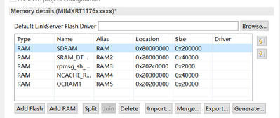

Next, switch to CM4 project. Add SDRAM space to memory table, just like what we do in CM7 project.
In properties-> Managed Linker Script, it’s better to announce Heap and stack space in DTCM. It also can be placed in SDRAM, but this should be careful.

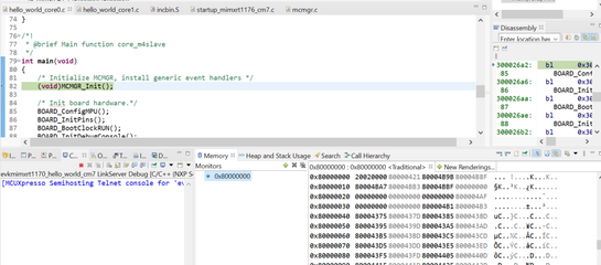

After that, we can start debugging. You can see that the SDRAM has been filled with CM4 image. Click Resume button, the CM4 project will stop at the beginning of the Main.

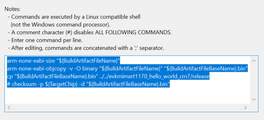

3.3 Right click the evkmimxrt1170_hello_world_cm4.axf in Project Explorer window, select Binary Utilities->Create Binary. A binary file called evkmimxrt1170_hello_world_cm4.bin will be created. Copy it to the release folder of CM7 project. If you want this work to be done automatically, you can add the command to properties->settings->Build stepes->Post-build steps

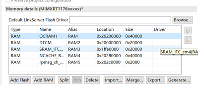

First of all, you mentioned in the article that CM4 program will be put into SDRAM to run, please ask me the current requirement is CM7 program to put into SDRAM, and CM4 program to put into SRAM(OCRAM or SRAM ITCM ?), How should the MCU Setting of cm4 and cm7 programs be configured?I followed my own configuration, and there was an error during compilation.
