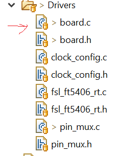

Was doing build just fine. When into the pin configuration tool. Came out. And now I'm getting:
Building target: PPsys-CIRAS4-HMI_PC143.axf
Invoking: MCU Linker
arm-none-eabi-gcc -nostdlib -Xlinker -Map="PPsys-CIRAS4-HMI_PC143.map" -Xlinker --gc-sections -Xlinker -print-memory-usage -Xlinker --sort-section=alignment -mcpu=cortex-m7 -mfpu=fpv5-d16 -mfloat-abi=hard -mthumb -T CIRAS4-HMI_PC143_RELEASE.ld -o "PPsys-CIRAS4-HMI_PC143.axf" ./TargetSpecific/Drivers/board.o ./TargetSpecific/Drivers/clock_config.o ./TargetSpecific/Drivers/fsl_ft5406_rt.o ./TargetSpecific/Drivers/pin_mux.o ./startup_mimxrt1062.o
c:/nxp/mcuxpressoide_11.5.1_7266/ide/plugins/com.nxp.mcuxpresso.tools.win32_11.5.1.202201181444/tools/bin/../lib/gcc/arm-none-eabi/10.3.1/../../../../arm-none-eabi/bin/ld.exe: ./startup_mimxrt1062.o: in function `ResetISR':
C:\Users\mike\git\CIRAS4-HMI_Repository\CIRAS4-HMI_PC143\RELEASE/../startup_mimxrt1062.c:683: undefined reference to `SystemInit'
c:/nxp/mcuxpressoide_11.5.1_7266/ide/plugins/com.nxp.mcuxpresso.tools.win32_11.5.1.202201181444/tools/bin/../lib/gcc/arm-none-eabi/10.3.1/../../../../arm-none-eabi/bin/ld.exe: C:\Users\mike\git\CIRAS4-HMI_Repository\CIRAS4-HMI_PC143\RELEASE/../startup_mimxrt1062.c:753: undefined reference to `main'

If I uncheck "Update Include Paths" it doesnt break. But that doesnt seem right. I never had to do that in the past.
6,058 Views
mspenard603
If I GIT->Reset and get my project working again and use the Pin Config tool, and do an Update Code without changing any pins, it breaks again. All my icons change and I get some new TargetSpecific/Drivers/ folder in my Project Tree again

mspenard603
Hi, yes, it's defined in #symbols as it has been. Which is why I'm very confused.
My icons look funny all of a sudden now too:
And I notice that /Drivers is now in two locations on my Project Tree ?!

jeremyzhou
Thanks for your reply.
Actually, it's my first time seeing the 'funny' icon, further, it seems like the system_MIMXRT1052.c and system_MIMXRT1052.h disappear in your project.
Lastly, can you replicate the phenomenon on the demos in the SDK library?

mspenard603
Any further thoughts on this????
6,004 Views
jeremyzhou
I was wondering if you can illustrate the steps of replicating the issue.
TIC
6,048 Views
mspenard603
I created a new workspace and opened the HelloWorld example. Then opened the Pin Config tool and updated. No issue. So something is going on with my project, which had been working for years now. Thoughts?
