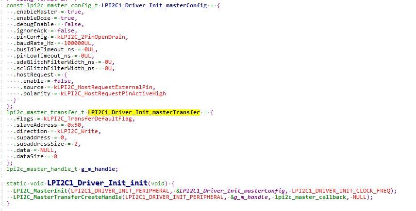

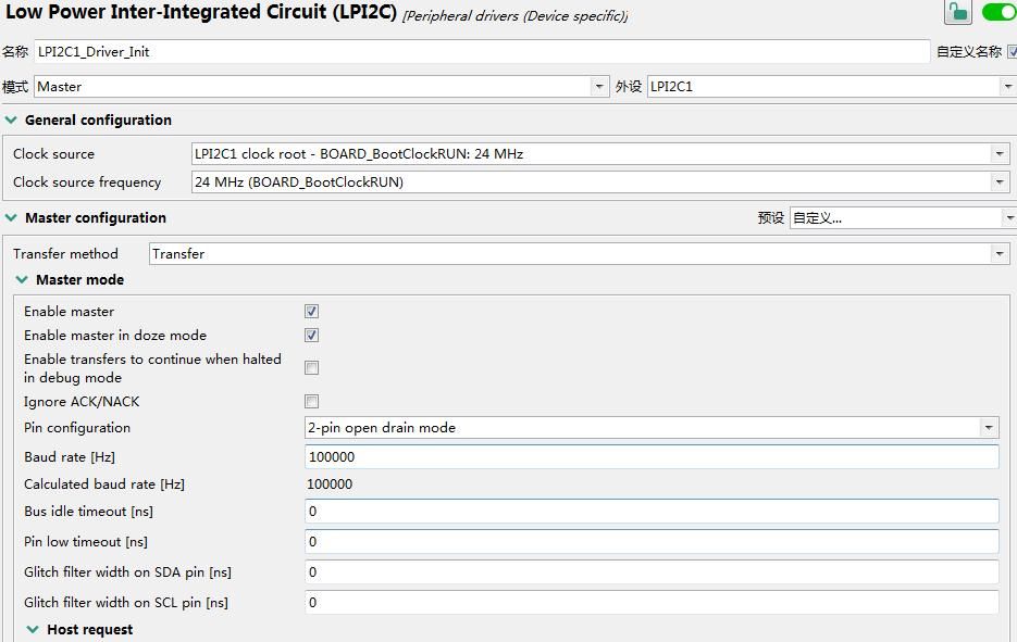

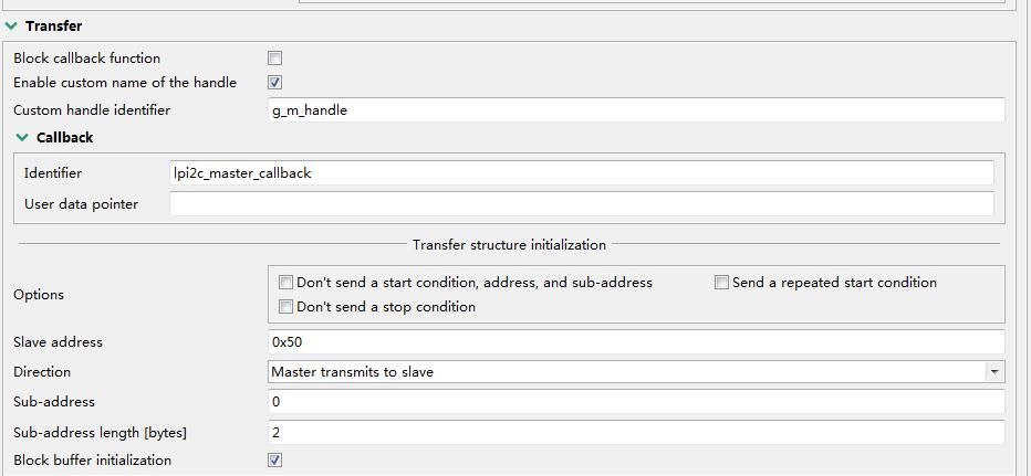

Hi:NXP Technical Support
 I had a problem reading EEPROM using RT1176 LPI2C. I used LPI2C1. When using Transfer MODE when the reVal = LPI2C_MasterTransferNonBlocking (LPI2C1_DRIVER_INIT_PERIPHERAL, & g_m_handle, & masterXfer);
Yes The I2C bus is always BUSY. The return value is always 900. (kStatus_LPI2C_Busy), Strangely enough, I used POLLING in the correct mode. reVal = LPI2C_MasterTransferBlocking(LPI2C1_DRIVER_INIT_PERIPHERAL, &masterXfer);
I can read and write the data I want normally, so I don't know what the problem is. I have a preliminary suspicion that there is something wrong with my configuration. May I take a screenshot to show you my configuration

Hi @ywjack ,
Firstly, I'd like to know whether you already figured out the line in the LPI2C_Master Transfer Non Blocking(), which return the busy parameter.
Further, I'd like to suggest you use the evkmimxrt1170_lpi2c_interrupt_b2b_transfer_master_cm7 demo instead of creating a demo by yourself for testing.
Lastly, can you share the waves that are visualized by the logic analyzer?
TIC
