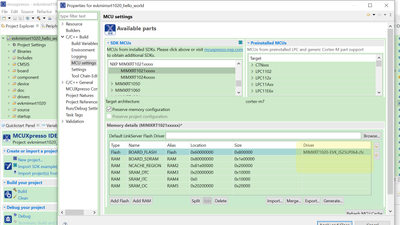

I'm trying to load my program to 1V8 QSPI Flash (IS25WP064AJBLE) on MIMXRT1060-EVK with processor MIMXRT1062 DVL5A. Currently the program runs just from SDRAM. I have tried some SDK examples like led_blinky and hello_world, turns out they are programmed on this flash without any problems. But I can not find the parts of code responsible for the flash programming. I tried also flash_component_nor example to figure something out, but it crashes in fsl_flexspi.c in MCR2 configuration. Do you have an example how to program this flash or some major steps that I have to follow needed to program the flash? I know that there are more possible ways how to load the program to the flash but I need that exact way like is used in led_blinky example. Because later I need to crate a HEX file to load the program to Teensy 4.1.

We are sending our mcu settings in attachment.
We've tried to use .cfx flashdriver and we defined symbols (-D)
XIP_EXTERNAL_FLASH=1
XIP_BOOT_HEADER_ENABLE=1
but there was problem with programming the flash. The program crashed and xpreso outputed "Break at address "0x2173a6" with no debug information available, or outside of program code." It seems the flash is being erased but the program can't load.

  Do you use the MIMXRT1060-EVK has issues? What's the code you are using? SDK project has issues or not? Seems it is related to your code. If the code has issues, it will meet the next time debugger connection issues. You need to erase the external memory at first, or enter the serial download mode, then download the SDK code at first.
Your .cfx and your settings are all OK:
It's OK.
So, I suggest you use the SDK project and download it in the serial download mode, then back to the internal boot mode, the issue will disappear. If your issues just with your own customer project, you still need to check your own project details. The code should not correct.

  Do you mean, you use the directly MIMXRT1060-EVK board, and that run the SDK code is OK, but your own code has issues with the flash, right?
  MIMXRT1060-EVK board in default is IS25WP064AJBLE, and that works OK with our SDK.
  About the flash programming, it is using the flashdriver with the IDE, so you can't find it in the app code.
If you are using the MCUXpresso IDE, the .cfx is the related flashdriver.
  If you want to check the flash program and erase and read, you can download this code to the internal TCM:
\SDK_2.9.3_EVK-MIMXRT1060\boards\evkmimxrt1060\driver_examples\flexspi\nor
  Then, debug it, you will find the details.
  You also can enter the serial download mode, then use the MCUBootUtility tool to download it.
