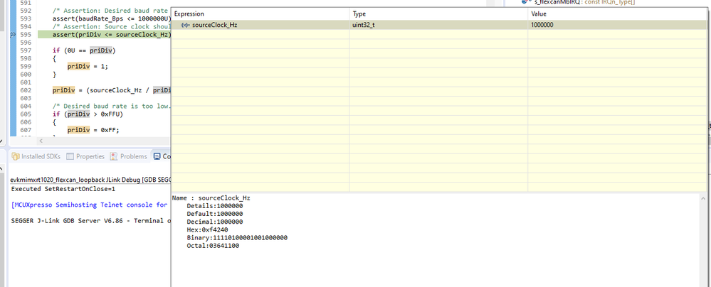

I am using MIMXRT1020-EVK board and interfacing CAN I run flexcan_loopback_functional example code and I am getting proper output.
But
Now I am using MIMXRT1020-custom board with chip MIMXRT1021CAG4A and interfacing CAN for trial purpose I am running  flexcan_loopback_functional example on board and code asserted at ( assert(priDiv <= sourceClock_Hz)).My CAN channel is on same port as in EVK board, I am using same crystal oscillators in my board as in EVK board but source frequency getting different. What should I check to rectify this issue?

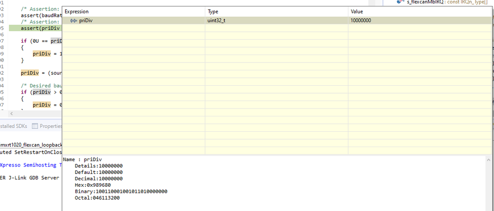

emb01_jtronix
Even I got sourceClock_Hz  20 MHz when I debug  the flexcan_loopback demo on MXRT1020 board but as I am using same example code with all the same configuration on my custom board why I am getting sourceClock_Hz is 1 MHz that is my concern.

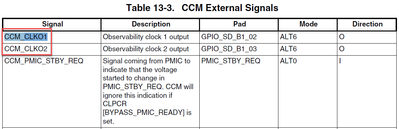

jeremyzhou
Thanks for your reply. It seems a bit weird, so I'd like to suggest you use the CCM_CLKO1 or CCM_CLKO 2 pin to output the clock, then you can use the oscilloscope to observe the clock.
It can help you to check whether the clock configuration works well.
Hope it helps.

jeremyzhou
1) Can you explain how to output the clock on this pin?
-- Please configure these two pins via the CCM_CCOSR register.

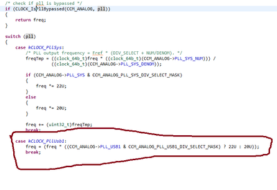

emb01_jtronix
Thank you for reply.
When I run example code (flexcan loopback transfer) on EVK board I am getting frequency as I shown in below image :
But when I am using same code (flexcan loopback transfer) on my custom board I am getting bypass pll. I am getting frequency as I shown below image:
Why I am getting bypass pll is there anything I have to check with my custom board(Hardware).

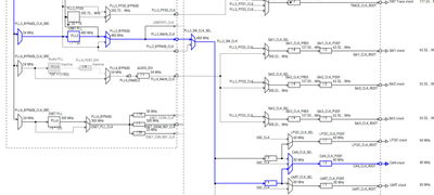

jeremyzhou
Thanks for your reply. It doesn't make sense. According to your test, the PLL3_MAIN_CLK is from the OSC (24 M), it obvious be inconsistent with the flexcan_loopback_transfer demo (as the below figure shows).
So I'd like to suggest you check the clock diagram of the flexcan_loopback_transfer demo besides check with your custom board.

jeremyzhou
The sourceClock_Hz is 20 MHz when I debug the flexcan_loopback demo on the MIMXRT1020 board, so I'd like to suggest you reconfigure the sourceClock_Hz to 20 MHz again.
