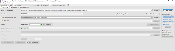

i'm going to use HyperRam on EVK 700-50577 rev C1 ( core M7 ) because my eval code is too large for DTC and ITC but when the program is downloaded after few times crash.
i've attached a simple program to test it.

I still checked your project, and  I saw that you linked your application to the HyperRAM address space, I wonder if the issue you are reporting can be reproduced all the time. But I  suggest you to check with the XMCD that the MCUxpresso Secure Provisioning embeds when programming your image.  With the tool, you can generate a bootable image and program over LPUART1 or USB1. Below a reference picture.

Thanks Diego, i will try but this is only a test. i must use hyper ram with debugger but i want to understand why all example for M7 present oin SDK works only with internal ram, isn't checked wirh flash or external ram? i understand that the mcu is not released in this date but, as me i need to check the mcu to decide if use nxp or another brand, and i have a lot of problem for simple things..

Update: maybe this will help to explain the issue:  see  RAW/POR image switch from the new MCUXpresso https://mcuxpresso.nxp.com/mcuxsdk/latest/html/boards/evkmimxrt1180/gettingStarted/topics/bootable_i...
