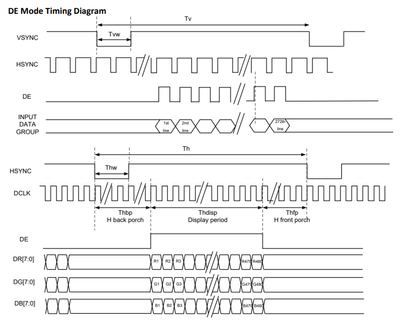

From the 7" datasheet:

I would like to clarify regarding the LCD mode. Since you have used a 7" TFT display and I see that your display also has option to set the DE or SYNC mode. I would like to understand what mode should be set in the LCD for the iMXRT1060 LCDIF controller. I see that the eLCDIF controller used all HSYNC, VSYNC, LCD_ENABLE and CLK. So it is bit confusing as to which mode should the LCD be tied to and do we need to make any changes to the controller settings.
Thanks for your help in advance.
10,335件の閲覧回数
carstengroen
Senior Contributor II
Hi @EmbeddedTech
I run the display as it is "out of the box". I do not set anything in the display, I "just" connect it as is, so that means I run it with "DEN" mode (thats how the eLCDIF/GPIO pins is set up)
