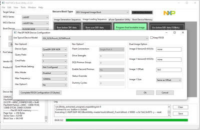

I've also tried flashing the bin to the board with the DAP-Link "Drap and Drop".  The flashing parts appears to work without issue (see screenshot)
Attached some screenshots.

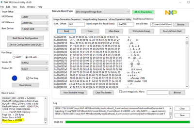

I just loaded the version from the web site (performing a mass-erase before doing so to be absolutely sure there was nothing in Flash that could disturb) and it worked normally on my MIMXRT1060-EVK.
If I compare the read-back code with yours the data is identical but I do however see a difference:
Notice that the block size is displayed as 32.0k but yours is displayed as 64k.

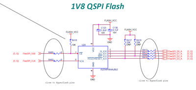

Does this means that you have modified the HW to use the MX25UM51345 Hyperram instead of the IS25WP128 QSPI flash? If that is the case it is not possible to boot with that code since it doesn't contain the correct flash configuration.
Otherwise I don't see that you have done anything wrong with the loading and that reference has been used for the last 2 or 3 years without any known issues.
The only other thing I can suggest is making sure that you have nothing connected on the Arduino connectors. Sometimes a pin is defined to hold the boot loader in its reset sequence so that a debugger can be attached before it continues and in case there were such an input held low it may be running but looping waiting for the pin to go high again.

No, the board is straight out of the box and the Boot_Cfg Dip is set up for QSPI.
https://www.mouser.de/ProductDetail/ISSI/IS25WP064A-JBLE?qs=TO8kDJPmCBR51kXJGmljCw%3D%3D
That's also the configuration I tried to define in MCU_Boot_Utility

That looks the same as my set up in NXP MCU Boot Utilit v3.4.0 so it looks like the same QPI flash is being used.

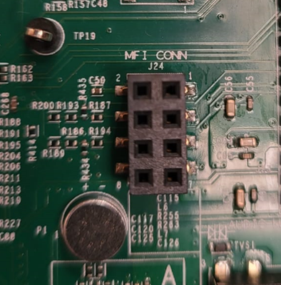

Did you check the Arduino pins to be sure that not are held to GND? Usually J24-10 held to GND causes the boot loader to loop until the debugger has been connected which is the only explanation that I have at the moment seeing that it looks like we have identical EVK HW and I don't have issues with that binary file.

I have no leads attached to any headers. The soldering also looks ok.
On my board, J24 only has 8 pins, but nothing attached, seemingly no chance to ground.

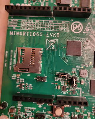

What I see is that you have an EVKB, which is a newer model and is not identical. The connector J24 (10-pin) is now called J17, for example.

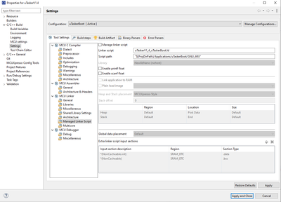

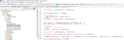

I attempted to build my own from the supplied files in GIT but there are errors during the build. I've attached an error log.
I followed the instructions here:
https://www.youtube.com/watch?v=C7DyE8RscHs&ab_channel=mjbcswitzerland
https://www.youtube.com/watch?v=p_eUGo6GypY&ab_channel=mjbcswitzerland
https://www.utasker.com/docs/iMX/MCUXpresso.pdf
I did perform the update to the linker scripts.
Any idea where the issue may lay?
Sam
Further Info:
12,279 Views
mjbcswitzerland
Specialist V
There is a bug in the GCC version that MCUXpresso V11.5 and V11.6 uses that causes this. It is also pointed out in the introductory email you received when you registered for the project.
Please see this:
https://community.nxp.com/t5/i-MX-RT/uTasker-Compile-Error-in-MCUXpresso/m-p/1535846#M21990
Mark
