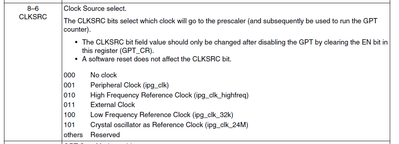

There is an error in document i.MX RT1010 Processor Reference Manual, Rev. 0, 09/2019, p.1659:
This is FALSE: A software reset does not affect the CLKSRC bit.

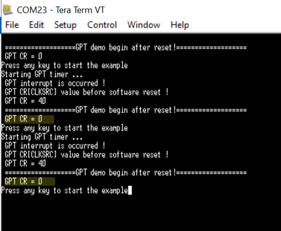

Hi @youngSheldon ,
I also use the SDK demo to test this feature:
evkmimxrt1010_gpt_timer

            PRINTF("\r\n GPT CR[CLKSRC] value before software reset !");
            PRINTF("\r\n GPT CR = %x", (GPT2->CR & 0x1c0));
            NVIC_SystemReset();
        else
          //  __WFI();
The printf log is:
So, really need to remove :
I already report it internally, it will be fixed in the next RT1010RM version.
Thanks a lot for your contribution.
Kerry

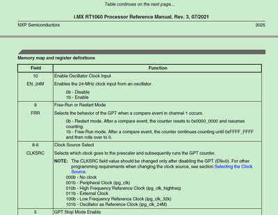

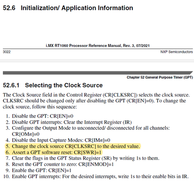

Nicki297
i can confirm that the software reset does reset the clock source on RT1060.
So in chapter 52.6 Initialization/ Application Information, it seems weird, after you selected the clock source the next step is to do a software reset.
Cheers!
