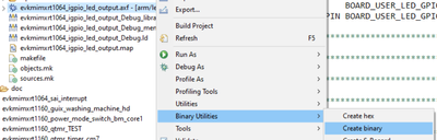

Is it possible when debugging a IMXRT with Jlink to load a raw binary in addition to the compilation .axf file?

There are 2 forms to get the .bin from the IDE, the first is explained on the next page MCUXpresso IDE: S-Record, Intel Hex and Binary Files | MCU on Eclipse.
The final form is the easiest when you build your project appears a Debug file there in the .axf file click right>Binary Utilities>Create binary.
