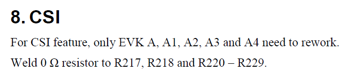

CarlosCasillas
In order to have the camera example working, you need to ensure your board version, considering the following note from “MIMXRT1050 EVK Extension Feature Enablement Guide” document:
Hope this will be useful for you.
Best regards!
/Carlos
