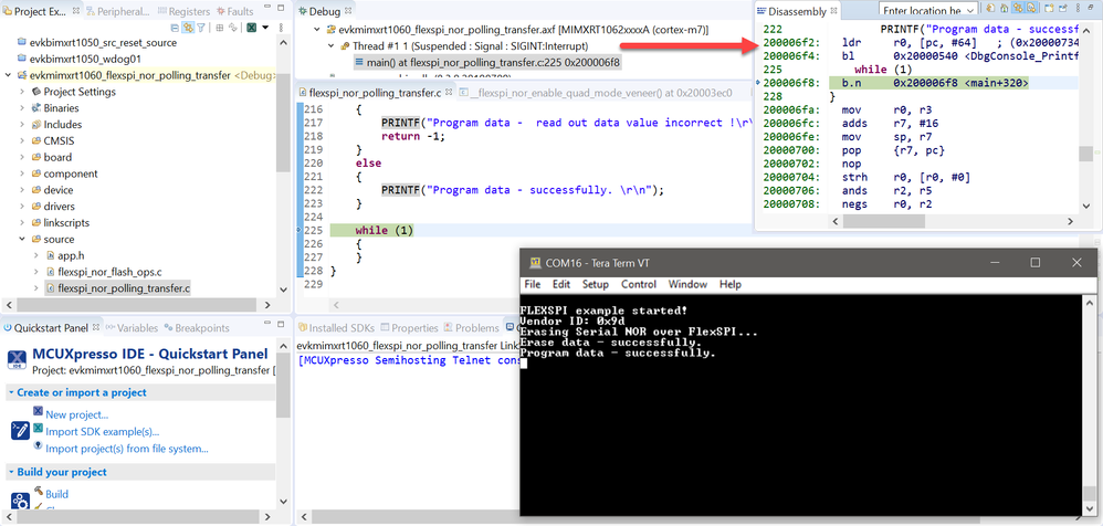

Thank you for clarifying. I believe I now understand what is going on. Based on your description, I tested on our evaluation board the "linked to RAM" option with it and without. If you have this option enabled, MCUXpresso IDE tells the managed linker script mechanism to simply ignore any flash regions listed in the project’s memory configuration. So you are not using the flash region, and when you power on the MCU again later on the application will be erased. In order to make sure that you are correctly writing to flash, you must disabled this option.
Flash your application again then restart it and it should be working correctly if everything was initialized properly.

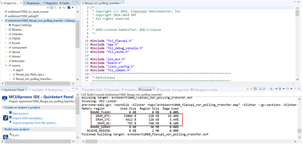

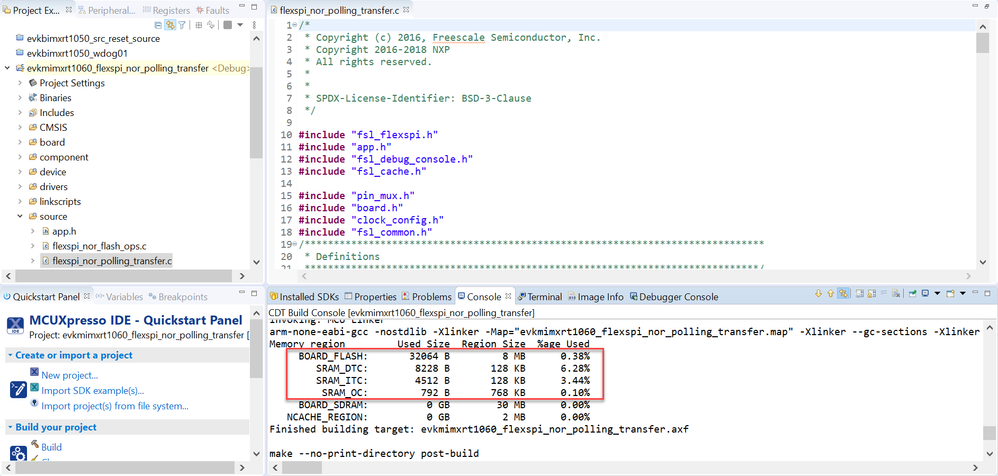

Hope you are well. Yes, this is what I mean. For example the flexspi_nor example without any modifications and without the option "link to ram" is partitioned in the following way.
When you run the example this is running from flash, as you may see the address is at 0x60000000.pastedImage_4.png
If I remove the debugger and power up the board again I will get the same results in tera term, because the application is in flash.
On the other hand if I select "link to RAM", then this means that I will be using the internal ram to run my application. Here is the memory partitioned:
The example will run without a problem, from this area which address is 0x20000000 and I can still access the flash operations as normal.
