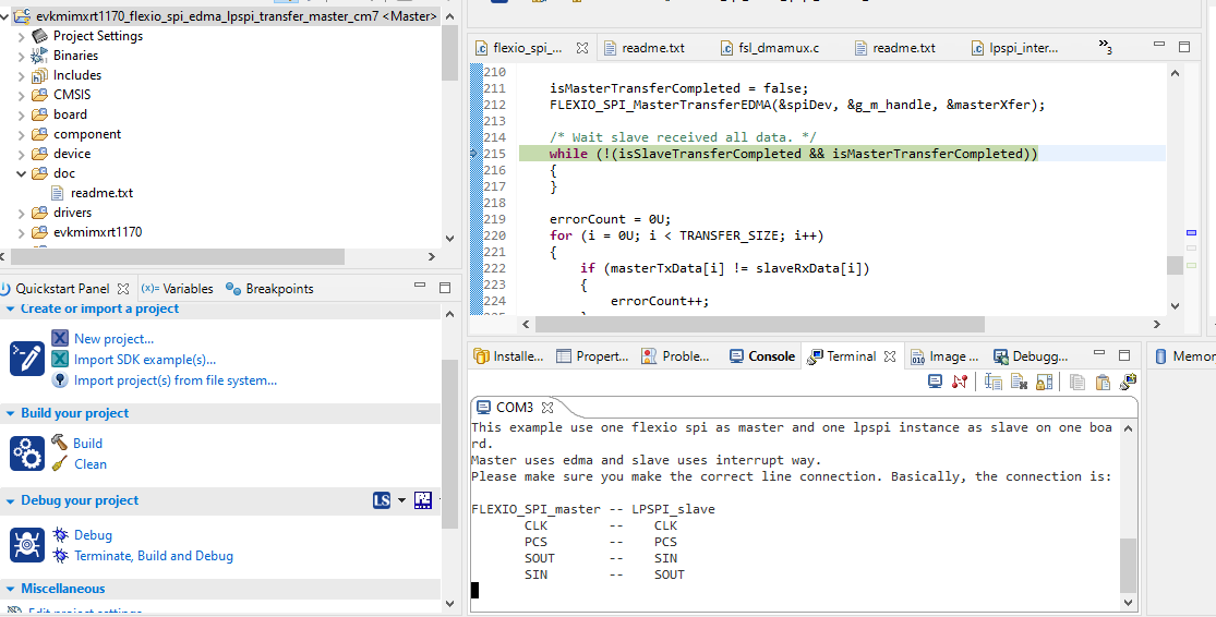

Hi All,
I started working on SPI drivers and its SDK driver Example codes (MIMRTX1170) "flexio_spi_master_edma_lpspi_slave.c"
did the connection as per the "Readme.txt" file
To make the example work, connections needed to be as follows:
SLAVE connect to MASTER
Pin Name Board Location Pin Name Board Location
SOUT J10-10 SIN J26-6
SIN J10-8 SOUT J26-4
SCK J10-12 SCK J26-2
PCS0 J10-6 PCS0 J26-8
not sure on this
Board settings
Remove 0Ω resistor to R406,R408,R404.
current execution is stopped here.
/* Wait slave received all data. */
while (!(isSlaveTransferCompleted && isMasterTransferCompleted))
attaching snap for the same.
any other board setup is required ?

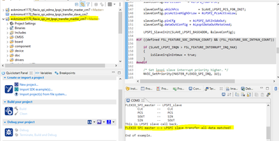

later I tried different example SPI Driver example ("flexio_spi_int_lpspi_transfer_master") it worked !

jeremyzhou
1) any other board setup is required?
-- Yes, another board is the slave and it runs the flexio_spi_int_lpspi_transfer_slave demo code.
Hope this is clear.
